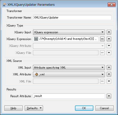

I have an XML Formatter transformer translating a query out of a MSSQL Database.  My XLD does not allow empty values, thus I always need to go through with a text editor and find XML Tags which look like this:
<KONTAKT2_EMAIL></KONTAKT2_EMAIL>
and change them to this:
<KONTAKT2_EMAIL xsi:nil="true" />
This is rather time consuming and I would like to perform this validity check in fme. I would therefore need to build in the following logic into the xml formatter transformer:
if Value = Null then XML Tag ends with xsi:nil="true" />
Any idea how to achieve this?
Best answer by takashi
Hi @robertdbuckley, the XMLXQueryUpdater with this XQuery expression replaces value of every existing xsi:nil attribute with true and adds xsi:nil attribute with value of true to every empty element missing xsi:nil attribute.
for $x in //*[fn:empty(child::*) and fn:empty(text())]
return if (fn:exists($x/@xsi:nil))
    then replace value of node $x/@xsi:nil with true
    else insert node attribute xsi:nil {true} into $x

  • Apr 23, 2018 2:56 PM UTC

Thank you!
