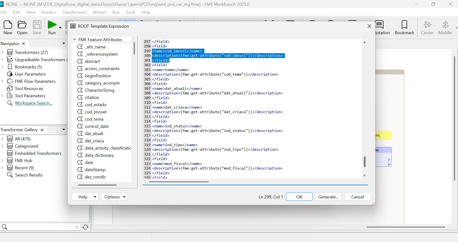

Hello everyone,
I am using an XML template like the one below to generate fields dynamically in FME Workbench:
<field>
<name>cod_imovel</name>
<description>{fme:get-attribute("cod_imovel")}</description>
</field>
<field>
<name>tema</name>
<description>{fme:get-attribute("tema")}</description>
</field>
<field>
<name>dat_atuali</name>
<description>{fme:get-attribute("dat_atuali")}</description>
</field>
My question is: if a new attribute appears in my source data (for example, atrr_1), is FME able to automatically add a corresponding field like this in the template:
<field>
<name>atrr_1</name>
<description>{fme:get-attribute("atrr_1")}</description>
</field>
Or do I need to manually edit the template each time a new attribute is added?
Best answer by takashi
See the attached workspace example.
My approach is to use a combination of AttributeExploder and an XQuery expression implemented in XMLTemplater. Assuming that you can keep only required attributes to be populated into the destination XML document.
You need to learn about XQuery language. Good luck!

The screenshot in your original question illustrates that you are attempting to convert name and value of each input attribute to values of <name> and <description> elements for each <field>.
I therefore assumed the input dataset should look like this:
However, in you shared Excel dataset, the actual source dataset has three attributes called "name", "type", and "description", as in:
Since the presumption about shcema of input feature in the original question was wrong, the solution would be completely different. AttributeExploder would be unnecessary.
To find an appropriate solution, I would recommend you to firstly learn the XMLTemplater Help, especially the Configuration/Parameters/Sub-Templates section.
