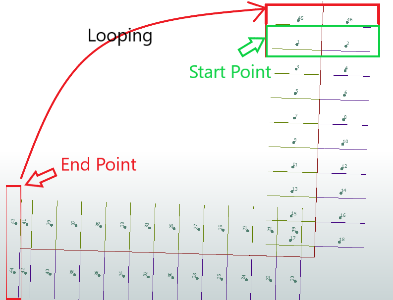

I have a line that I've chopped up and intersected with perpendicular lines to be labeled with odd and even numbers on either side.
I used the counter transformer to label the perpendicular lines, but I encounter a looping sequence numbering that doesn't quite work for what I intend. See the image below.
What I would like is to have the sequencing start at the label 45 and 46 and end at the current endpoint. Any suggestions will be appreciated.
Please see my workspace below.

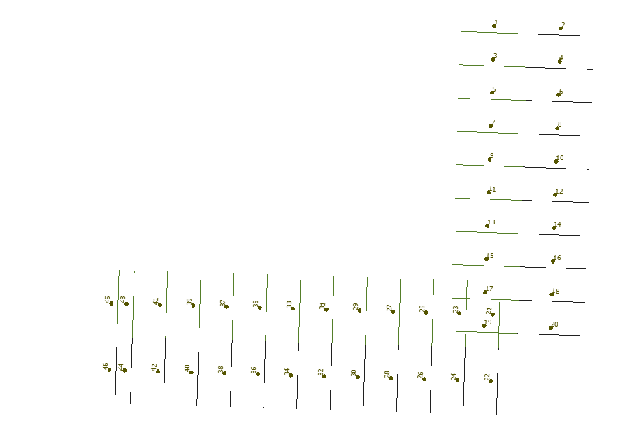

Try putting a measure generator before the distance chopper transformer and a measure extractor after it, then sort by measure.
This worked perfectly well with my workflow. Thanks for the support.
