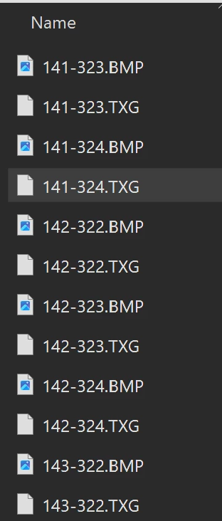

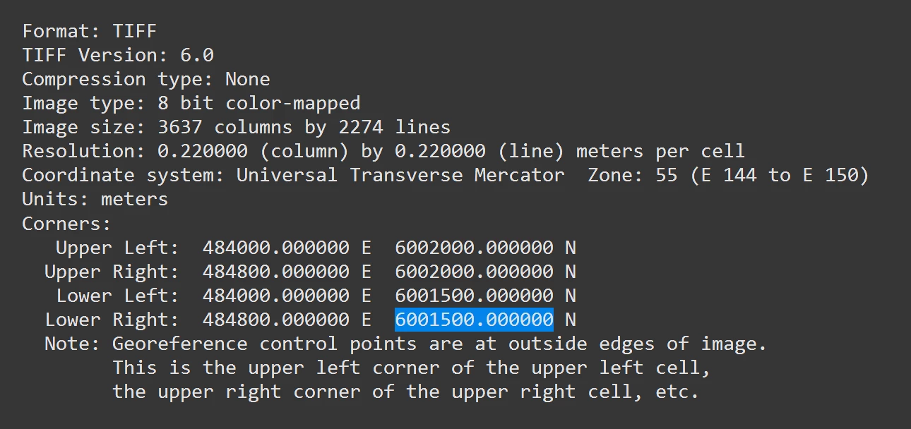

I have a folder of old aerial imagery tiles with .txg georeference file. Inside .txg file, there are coordinates of the four corner.
I can manually copy those corner coordinates into the RasterGeoreferencer transformer, but is there any way to automate this process and mosaic all tiles into one raster?

I’m going to suggest a wildly different workflow: use those txt files to create tfw files (TIFF World file).
A tfw file has the following structure:
Line 1: A: pixel size in the x-direction in map units/pixel
Line 2: D: rotation about y-axis
Line 3: B: rotation about x-axis
Line 4: E: pixel size in the y-direction in map units, almost always negative[b]
Line 5: C: x-coordinate of the center of the upper left pixel
Line 6: F: y-coordinate of the center of the upper left pixel
So for your example that would be:
0.22 0 0 -0.22 48399.89 6001999.89
You can use the Text File reader to read the text file, each line turns into a feature, and then use StringSearchers to grab the information you need from the file.
Then when FME (or other GIS software) reads the TIF file it’ll see the tfw file and automatically use that for georeferencing.
