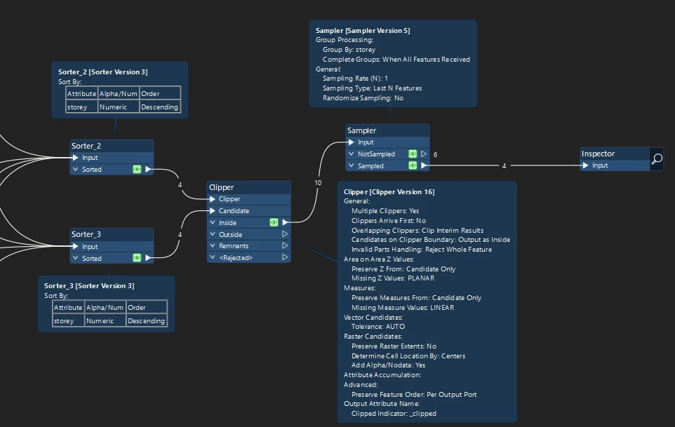

I have no idea if this will work on real data but this is what I tried and had decent results.
I started by sorting the storeys by number with top story first - Feed all features into the Clipper and Candidate ports of the clipper - set the “Overlapping Clipper” to “Clip Interim Results”.
After that I sampled the last feature per storey.
I suspect the logic is flawed when it comes to real world data but could be a good starting point

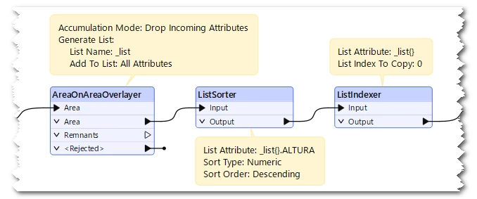

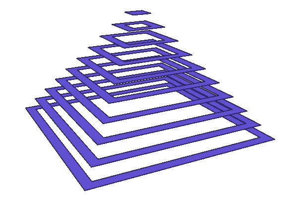

Hi ​@julian_tala ,
If I understand your goal correctly, this could work.
  1. AreaOnAreaOverlayer: Input all the storey areas together into an AreaOnAreaOverlayer and populate attributes into a list attribute.
  2. ListSorter: Sort the list elements by ALTURA numeric descending.
  3. ListIndexer: Extract the first element (index = 0) of the list to restore the attributes for each storey.
Result: z = ALTURA
