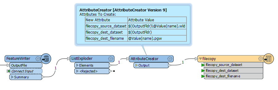

Best answer by ebygomm
You'll have to either use a filecopy writer or a system caller to create the pgw. I'd recommend swapping the writer for a feature writer, you can then use the output to trigger a systemcaller or send to a file copy writer
Create with filecopywriter (original wld file remains)
Rename with system caller - wld file renamed

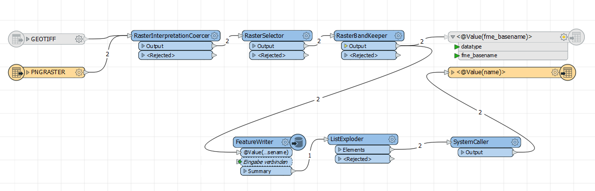

Is it possible to rename the files during the process in the picture?
  • Oct 16, 2019 9:50 AM UTC

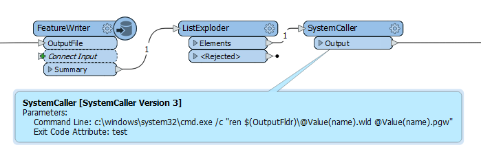

For what is the ListExploder?

If you are writing several png's at once, the names of them are returned in a list from the summary port of the FeatureWriter, this needs to be exploded so that you rename the wld file for each output png
  • Oct 16, 2019 11:50 AM UTC
Thank you! It nearly worked.
I used the the systemcaller to rename the files with this command line:
C:\\Windows\\system32\\cmd.exe /c "ren "OutputFldr\\*.wld" "*.pgw""
I got the desired PNG+PGW files.

Can you share a screen print of your workflow, it sounds like you're sending a non raster feature to the png writer
Edit: you've already written the file with the featurewriter, there is no need for the original writer after the system caller. You are sending a non raster feature into that writer, hence the message.
Thank you so much! It works!

If you're using the rename statement posted above, you don't actually need to explode the list, you can just go straight to the systemcaller

Do you mean that one?:
  • Oct 16, 2019 12:06 PM UTC
Yes, that will rename all files with extension wld to pgw. So you only need to call it once, not once per png
