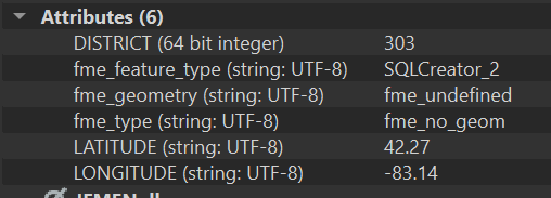

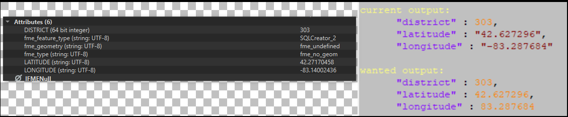

Hello, I am reading some attributes from a database. Some are in string format, some in number (int, float etc.). I want to write these attributes to a json file.I noticed that all the attributes in string format are automatically output in quotation marks and the numbers without. In my case I have three attributes: district, lat and long. District is an int, lat and long are strings. How can I change lat and long so that their output is also without quotation marks like the district one (see image) ?
Best answer by ebygomm
katt wrote:
I am using a JSON Templater. Maybe there is workaround to display the lat and long values without quotation marks?!
You can do something like this
"district" : xs:int(fme:get-attribute("district")),
"lat": xs:float(fme:get-attribute("lat")),
"lon": xs:float(fme:get-attribute("lon"))

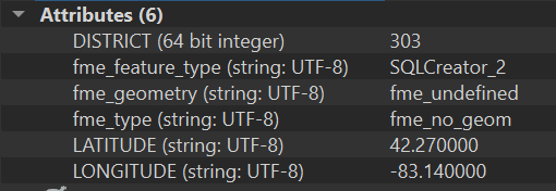

thank you @carmijo​ . I have already tried this. I used .2f in the string formatter and look at the output. It is still a string and not a float even though it has been reduced to two decimals.
