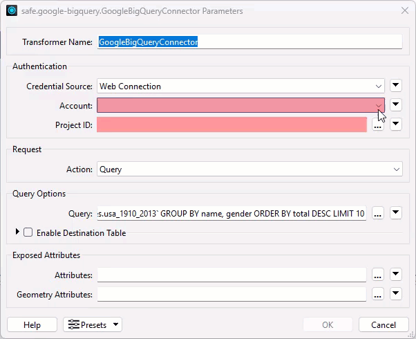

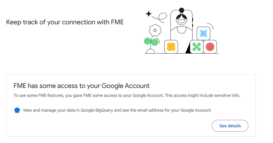

I’m trying to query data from BigQuery using the GoogleBigQueryConnector and get a ‘Failed to get authorization header’ error message when trying to select a project. FME has been given access to my Google account to view and manage data in BigQuery.

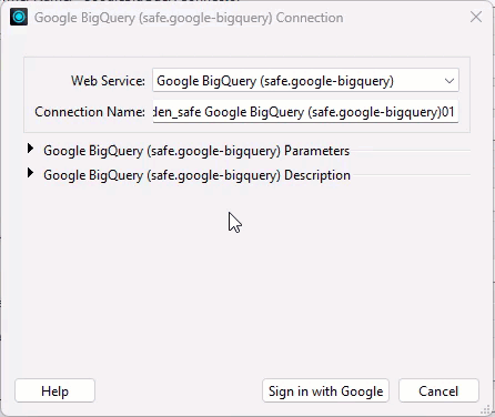

I don’t appear able to test the web connection that I created; I had created it by hitting the Sign in with Google option in the screenshot.
I’m not sure where I would enter the client ID or Secret on FME.

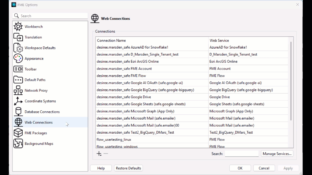

Besides that, I do see you're using the FME package of BigQuery (safe.google-bigquery), which we do recommend! You can test this web service connection in FME by going to:
Tools > FME Options > Web Connections > Manage Web Services

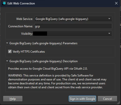

Under the Manage Web Services tab, find your Google BigQuery (safe.google-bigquery) web service definition, then scroll down and click Sign in with Google to test the connection as shown here:
This should give us more clues to why authentication is failing.
Note: the Manage Web Services dialog is also where you can supply your own Client ID and Secret. This article has a bit more details on this:
Let me know what you find! I'm curious about any error messages or at what stage the authentication fails (during login or after).

​@fmejohn93 That’s so odd! The only thing I can tell is that the Account looks a bit different than what I expected.
My web connection still had the package name (safe.google-bigquery) attached to it like I have here:
So I’d recommend double checking the Web Connection Account, to be sure it matches the one you connected to successfully from the Manage Web Services dialog.
You might need to click Add Web Connection.. to ensure you have the right one or to create a new connection.
Let me know how it goes!
