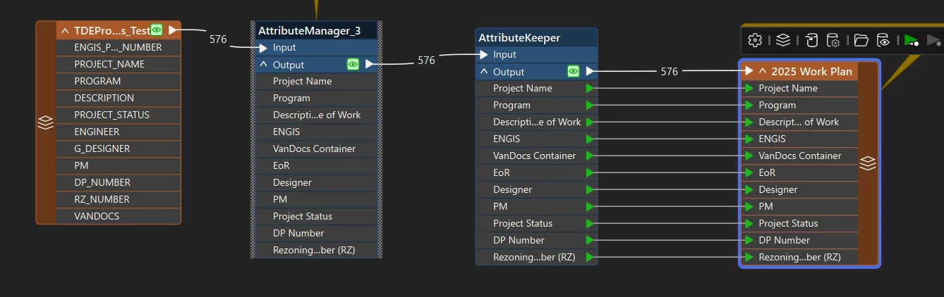

Trying my hand at a workflow that takes certain records from a GIS feature class and writes them into a Spreadsheet XLSX (2025 Work Plan).
I’ve renamed the attributes from the GIS feature class schema to match the relevant fields in the 2025 Work Plan Spreadsheet with no issues. When I examine them, they look good in the table.
The Spreadsheet has certain Excel-only fields that are not included in the GIS feature class. What I am finding is that while the information is being translated into the 2025 Work Plan Excel Sheet, it is also writing the remainder of the fields from the GIS feature class into columns in the 2025 Work Plan Excel Sheet that are Excel-only.
This is despite trying to remove the excess fields in the Writer. And even mapping the fields directly to the corresponding fields in the Excel Writer. I had tried experimenting with the ‘Update’ parameter rather than Insert, but that caused errors.
Are there any suggestions to ensure only the specified GIS fields are written into the WorkPlan Spreadsheet and the excel only fields within the spreadsheet are left alone and not touched?

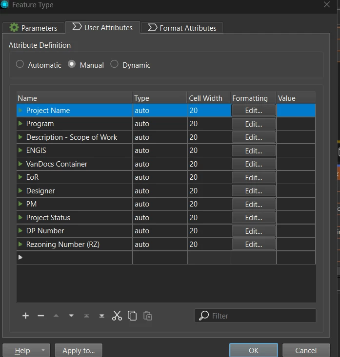

After much tinkering I found that the solution was to add an AttributeCreator to add the Excel-only fields and leave them as blank values. Then to include the same newly created Excel-only fields in the AttributeKeeper as well as in the Writer when set to ‘Manual’ and populating the fields in a way that matches the schema/order of how they appear in the Excel spreadsheet.
This worked and the Excel only columns aren’t touched as expected.
