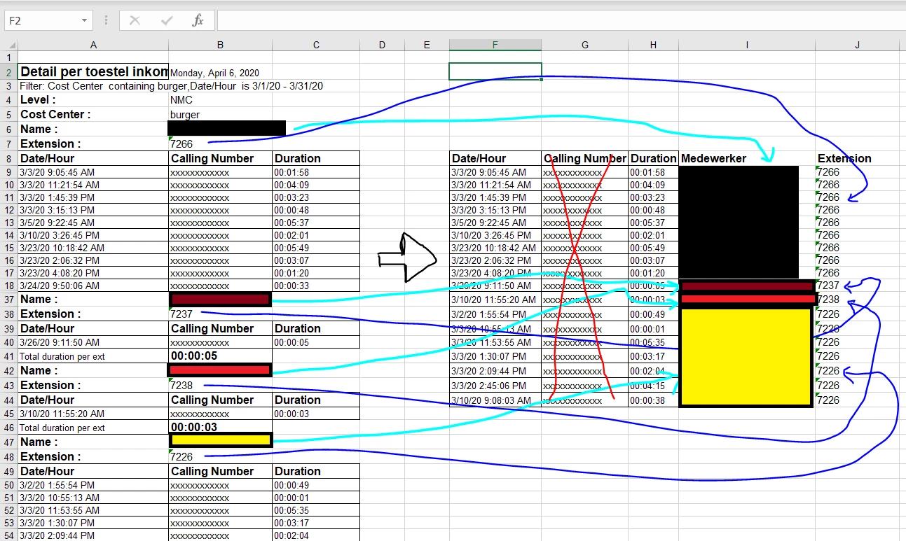

Hello,
I have an export from callcenter software and I want to transform it like this.
Original data is on the left and I want to become what's on the right.
What I tried:
Read the source Excel with columns A, B and C as attributes.
Then with a TestFilter I created "Name", "Extension" and "Contents" port but I'm not able to join them.
Any push in the right direction please? :-)
Thanks and stay safe!
-Jonathan

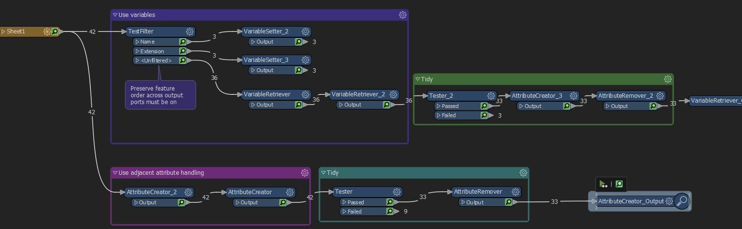

Here's an example of a couple of ways to do it with some mocked up data, using either variable setters and retrievers or adjacent attribute handling. You'd need to do a bit more tidying up of the real data but that should be fairly straightforward

To be honest I'd nearly always opt for the adjacent attribute handling. Open ended transformers like the variable setters make me uneasy :-)
