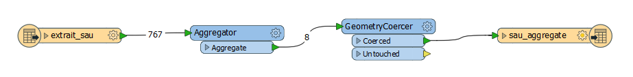

I use the Aggregator to merge polygons based on one attribute.
  • When the output is Shapefile, multipolygons are created and all works fine.
  • When the output is OGC Geopackage or Spatialite, FME creates a GeometryCollection instead of multipolygons (and I can't use GeometryCollection with others GIS softwares).
I want to force multipolygons instead of GeometryCollection. When I use GeometryCoercer, nothing is coerced.
Thanks a lot for your help :-)

I tried to create the attribute geopackage_type with values wkb_geometry_collection and also wkb_multi_polygon. The new attribute is created but the GeometryCoercer can't export anything:
I get a lot of warnings messages from GeometryCoercer, like "Cannot coerce from IFMEPolygon to fme_multi" or "Cannot coerce from IFMEMultiArea to fme_multi".
If I remove the GeometryCoercer, the 8 multipolygons are exported in my Geopackage but they are GeometryCollection and not multipolygons.
Thanks for your help :-)

Deaggregating before aggregating solved the problem:
takashi
  • May 5, 2018 12:42 PM UTC
If you need to transform a homogeneous aggregate (IFMEAggregate) consisting of only polygons (IFMEPolygon) to a multiarea (IFMEMultiArea), you can just use the GeometryRefiner.
