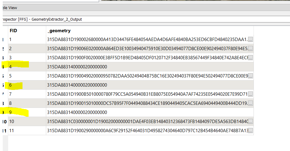

Hello there,
we have some feature with not a valid geometry, we used geometry validator transformer but it did work, is there any other way to filter only the valid Geometry
Thanks
Best answer by lau
I would use the GeometryFilter
I agree with @lau
In this case the transformer GeometryFilter is good option.
  • Oct 9, 2018 1:49 PM UTC
I have the same issue with invalid geometries getting passed through the GeometryValidator. My current work around is to check and then repair the geometry in ArcMap.
