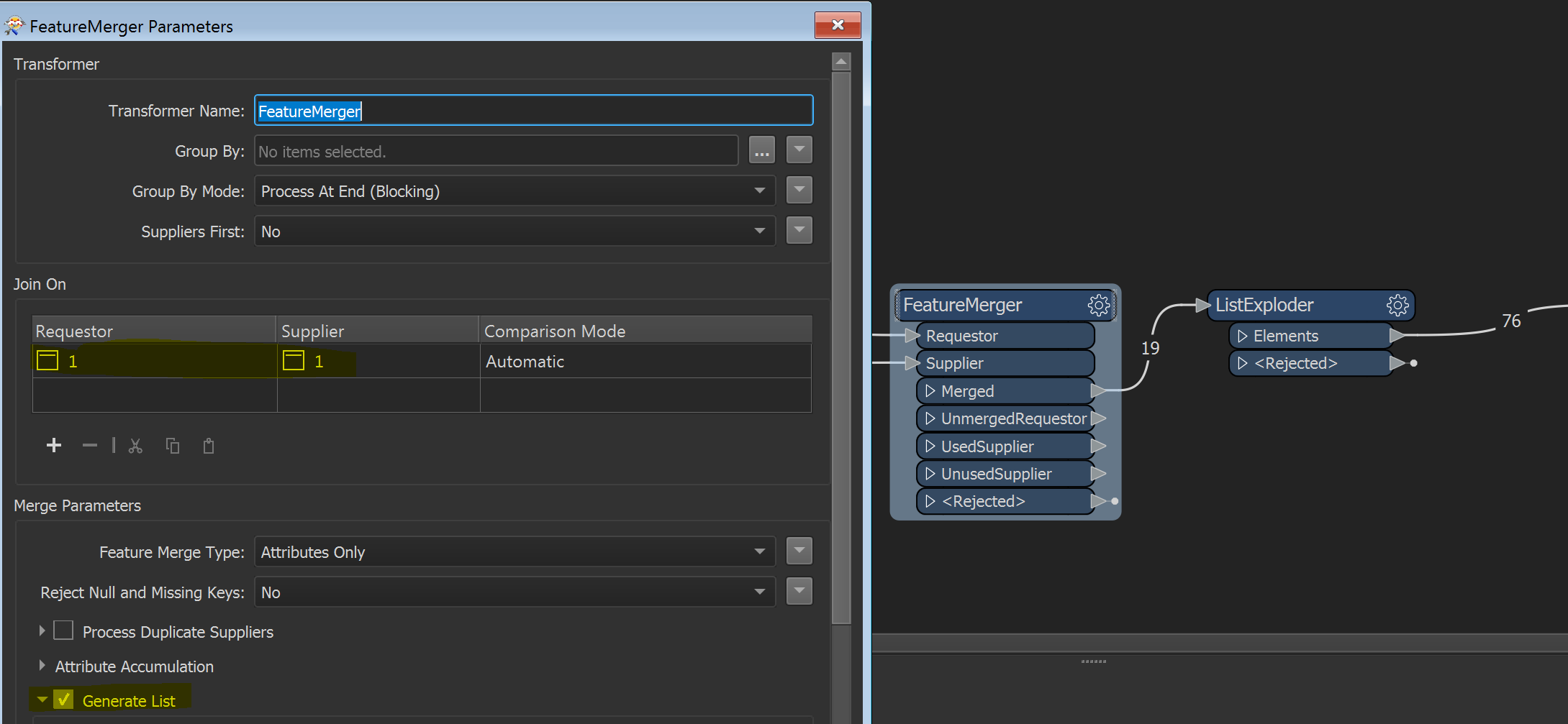

Good morning,
I am trying to come up with a way to generate lines where the starting locations are contained in one data set and the end points are contained in another data set. I have 19 "start" points and 4 "end" points; I need a line from each start point to each end point - So I should end up with 76 lines. Any guidance on how I should accomplish this would be greatly appreciated. I've been toying around with lists and trying to loop through them to create all the pairs of points that I need to feed into the LineBuilder, but I've been struggling with how to get it done.
Thanks,
Brian
Best answer by ebygomm
You can unconditionally merge in the FeatureMerger (Requestor = 1 & Supplier = 1), build a list of the suppliers including the coordinates from the suppliers,then explode this list, and use a vertex creator to add the supplier point to create a line
erik_jan
Forum|alt.badge.img+26
  • Feb 5, 2020 3:42 PM UTC
Read both Start and End points.
Use CoordinateExtractor to extract End point X and Y.
Then use FeatureMerger (1=1) to merge the X and Y from all end points to the start points (start = requester , end = supplier, merge all suppliers using a list).
Use ListExploder to create the pairs and add the end point using VertexCreator.
Hope this helps.
  • Feb 5, 2020 3:44 PM UTC
cunningham.ba
Forum|alt.badge.img
Thanks guys... I actually ended up stumbling upon that exact solution myself about 2 minutes after my posting this morning. I found another forum post where a user highlighted the ability to do the 1=1 join in the FeatureMerger and then I utilized the list from the merger to get my points. I was previously unaware that you could do the 1=1 join in the FeatureMerger... that is extremely helpful! You learn something new every day!
I had been working on this most of the afternoon yesterday and made my post this morning before jumping back in to work on it. After having my fresh set of eyes on it this morning, I came across the solution pretty quickly.
Thanks for the validation of my solution!
Brian
