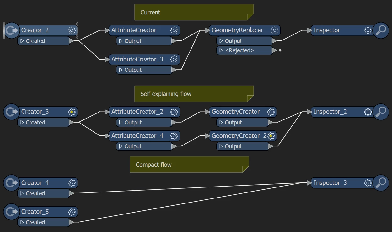

jkr_wrk
Forum|alt.badge.img+37
  • Aug 27, 2025 9:37 AM UTC
I like this question.
Yes, I would like the AttributeFilter to remove the <Emtpy>, <Missing>, <Null> (with option to activate). Keep the <Unfiltered> because that's what it is. All features that did not match the other ‘tests’.
And move the <Unfiltered> to the bottom of the list (below the Attribute values).
The Counter should have Count Scope: Local as default.
The Sampler should have Sampling Type: First N Features as default
Add AttributeCreator functions to the Creator.
Make a GeometryCreator with the Geometry Source, Geometry Object, Coordinate List and Coordinate System parameters.
My brain does not like that a Creator can make geometry but no attributes and no other transformers can make geometry like the Creator can.
Give the PythonCaller basic script error feedback so I don’t need to run an entire workbench for the error invalid syntax.
Remove milliseconds from the %S option in the datetimeconverter or add a seconds only option.
Change the Type parameter to Output Format in the DateTimeStamper. Maybe add a Group Processing on the DateTimeStamper, this would improve run time enormous when stamping thousands of features with just the current run time. Now I use a VariableSetter and VariableRetriever to prevent FME to give every feature their own millisecond datetime.
Give the HTTPCaller: Query String Parameters, Multipart Upload and Headers box some TLC so it’s easy to add multiple headers or move upload body parameters from/to headers. Maybe add the option to import a PostMan script?
Just some things that come to mind.
  • Aug 27, 2025 9:42 AM UTC
You can set Attributes in a Creator

jkr_wrk
  • Aug 27, 2025 9:58 AM UTC
Oh, thanks. I did find this option and deleted it from memory. But I don’t think my colleagues would like me using this option. Wow. I can even hide CoordinateExtractors, DateTimeStampers etc. in AttributeRemovers never to be found:
I guess the purple arrow gives a hint.
david_r
  • Aug 27, 2025 12:41 PM UTC
Devious renaming, I’m loving it :-D

redgeographics
VIP
Forum|alt.badge.img+63
And this is why I’m working very hard on the WorkspaceFixer3000 😄
jkr_wrk
  • Aug 27, 2025 2:59 PM UTC
I hope it’s not able to detect these shenanigans:

redgeographics
VIP
Unfortunately not (yet? I don’t think I can get the layout of the workspace out of the Workspace reader and I don’t really want to dive in to the underlying XML), but this violates so many Best Practices…
