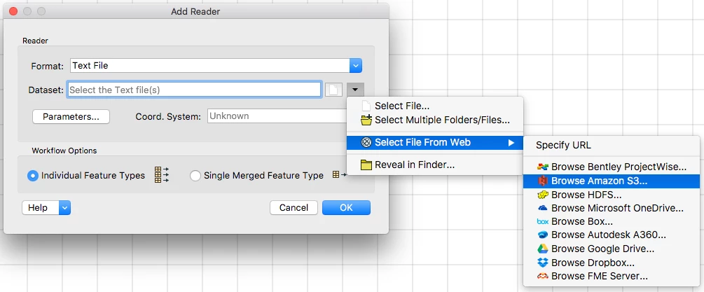

Currently, it is not possible to use an FME Server parameter to reference an S3 Bucket. However, if you want to reference a file directly in a Reader or FeatureReader you can browse your S3 bucket in FME Desktop and select the file. This requires a AWS Web Connection.

Hi @olivermorris,
