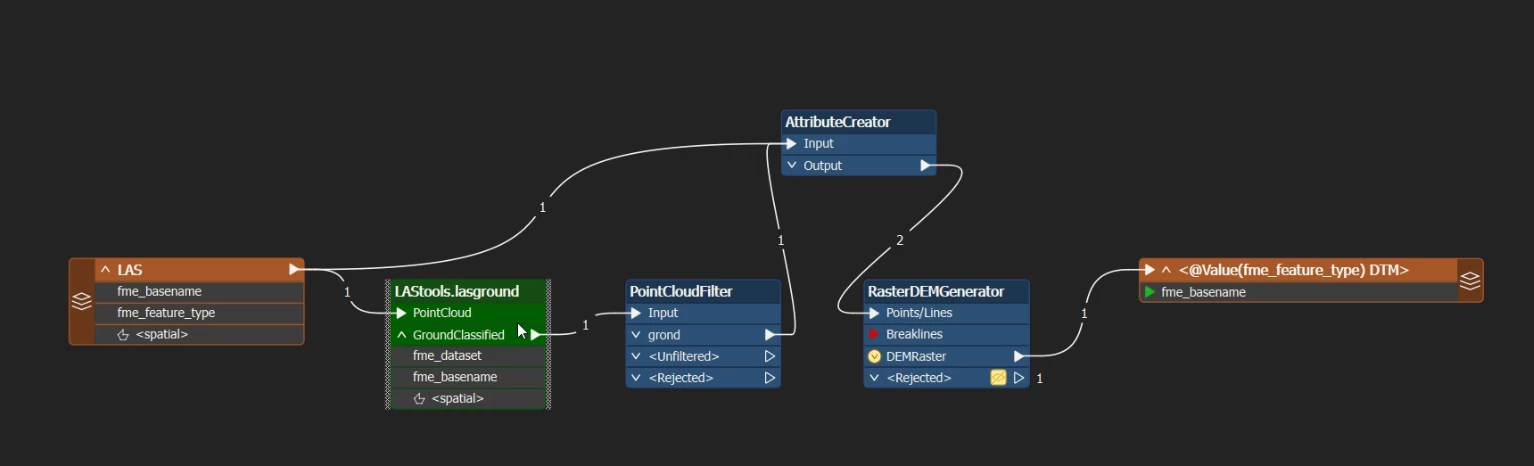

I’m using the rasterdemgenerator and I can’t get the fme_basename passed it.
I have some lidar tiles and I want to make a DTM from them. I can do everything, but I cant get the DTM named like the input las file. It has either no name or it has the name of the transformer.
There is an old forum post where Takashi tell’s someone to expose the FME_feauture_type, fill it with the FME_basename, use a group by (using the FME_feauture_type) in the rasterdemgenerator and than use it as the raster file name.
It doesn’t work for me…
Any other suggestions? I’m on FME 2025.0

yes because after the lastools transformer I loose my fme_basename. If I inspect it, it says fme_basename: missing
So I expose the FME feature type, fill it with the fme basename before the lastools transformer and try to carry it through that way
When I try this:
It works, but it’s not a DTM anymore as he also uses the unfiltered point cloud. I tried the geometryremover, but that doesn’t work. I get errors that way.
To me this still sounds like a very strange thing to do.
What happens when you create a new attribute, and give it the value of fme_basename? Use that same attribute for GroupBy in the RasterDEMGenerator.
koenvdw
Forum|alt.badge.img+7
  • Jul 21, 2025 1:59 PM UTC
Ok, that works. I swear it was the first thing I tried… Very strange, maybe the cache clearing helped…
