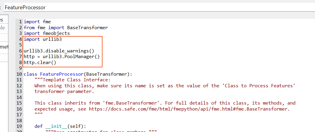

crystalatsafe
Forum|alt.badge.img+19
Hi ​@topotoma
I'm glad to hear that updating the SharePoint package resolved the error for you. Since the upgrade worked for you, I don't anticipate that you will need to use the PythonCaller workaround, but I can share the script.
This script resolved that error in the case where updating the SharePoint package did not.
import urllib3
urllib3.disable_warnings()
http = urllib3.PoolManager()
http.clear()
Copy and paste the code into a PythonCaller directly under "import fmeobjects". Place this PythonCaller after the creator and before the FeatureReader.
I also wanted to share a feature on the PythonCaller, (and other transformers) in case it's helpful. There is a feature called Parameter Presets, which lets you save parameters and reuse them.
  • In the PythonCaller (at the bottom left) select Presets -> Save as -> New Preset
  • Give it a name and save it
  • Now in a new workspace, when you click on a PythonCaller, you can select Presents -> Load 'name' to load the saved parameters.
This will allow you to save different versions of the PythonCaller (or other transformers) and you won't have to copy/paste anything over when you open a new workspace.

Hello Crystal,
Many thanks for your reply. Well, I couldn’t have guessed myself the solution you proposed nor updating the connector. I thank the contributors of the forum, this is an invaluable ressource.
Have a great day.
