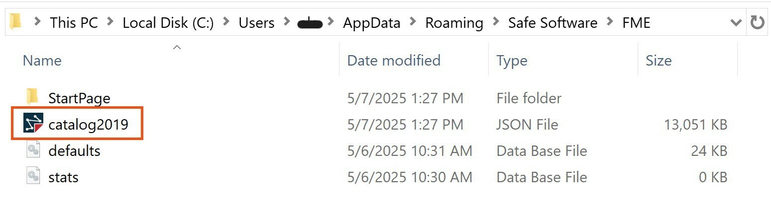

  • On the machine running FME 2019 or earlier, go to:
    • C:\Users\<username>\AppData\Roaming\Safe Software\FME (refer to the attached image)
  • Delete the catalogXXXX.json file of the affected Workbench (you might need to enable Hidden Items under View tab). This will force Workbench to download the newly updated JSON file when you start it.
  • Launch the affected FME Workbench.
Note: If the affected version of Workbench has not been opened in the past 24 hours, the update should be applied automatically the next time you open Workbench, and you should not need to follow the steps above.
