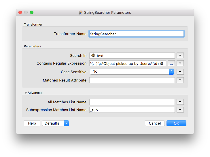

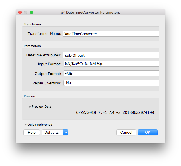

Hi @mvloenhout, a possible way is:
  1. Extract date/time part and user number part from the "picked up" record with a StringSearcher.
  2. Select only the features of interested user number (2 and 9) with a Tester.
  3. Convert the date/time string to FME standard format with a DateTimeConverter.
  4. Sort the features by date/time (FME standard format) [Edited] ascending with a Sorter.
  5. Select first features for each user number with a DuplicateFilter.
StringSearcher Parameters Example: Modify the Contains Regular Expressions appropriately according to the actual input text structure specification.
DateTimeConverter Parameters Example: Modify the Input Format appropriately according to the actual input date/time format specification. See these links to learn more about FME date/time.
