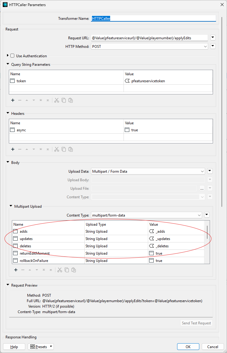

The one thing tha took me the most time was to understand how I should pass my objects to ArcGIS using HTTPCaller and the applyEdits method.
First of all I figred I’d send groups of objects to applyEdits, in my case I ended up sending 1000 objects at a time to ArcGIS. For each object I wanted to send to applyEdits, I had to figure out if this was a deletion of an existing object, and update to an existing object or a new object. For these groups I had to make a separate list of JSON objects to pass to ArcGIS, ending in three separate groups of objects with a total of 1000 objects.
Not 1000 inserts + 1000 updates + 1000 inserts, but inserts + updates + inserts = 1000 objects.
For inserts and updates I needed to send a list of complete Esri JSON objects to ArcGIS. I encoded the geometry into Esri JSON format by using the GeometryExtractor, and created the rest of the Esri JSON object by using the JSONTepmlater. I was updating a set of object types and I created an XML-file with JSON templates for all my object types. I used the template I fetched from this file as my JSON template in JSONTemplater.
For my deletes, I simply used a JSON list containing the GlobalID for each object I wanted to delete.
To use these three JSON lists in HTTPCaller was quite easy, when I first realized how. In the Multipart Upload section I added three extra parts to upload. “adds” for my JSON list of inserts, “updates” for my JSON list of updates and finally “deletes” for my JSON list of deletes.
It looks like this:
In the end, this setup in HTTPCaller made my day using the ArcGIS applyEdits method.🤓
