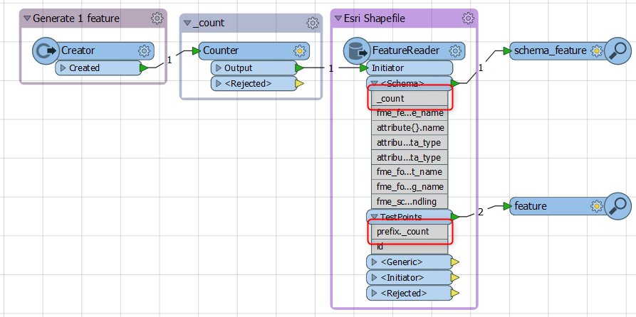

FeatureReader does not prefix attributes on SchemaFeature.
  • Mar 15, 2019 9:46 AM UTC
  • 3 replies
  • 81 views
nielsgerrits
VIP
Forum|alt.badge.img+67
When the FeatureReader outputs a SchemaFeature, the attribute handling differs from Features. For example, I use the Prefix Initiatior option a lot, but it does not work for SchemaFeatures.
Is this how it should work? Thanks.
Best answer by david_r
I think this is as expected. Can you perhaps elaborate on why this is problematic?
david_r
  • Mar 15, 2019 10:12 AM UTC
takashi
  • Mar 15, 2019 10:18 AM UTC
The attributes from Initiator feature will always be merged the the features output via the Schema port, the Initiator port, and the Rejected port, without changing their names.
I think the Attribute and Geometry Handling parameters are only applied to the data features.
nielsgerrits
VIP
It is not problematic. It is different behavior, where I expected it to be uniform. I just wanted to check if this is expected behavior so I can erase the note I made in my head :-)
