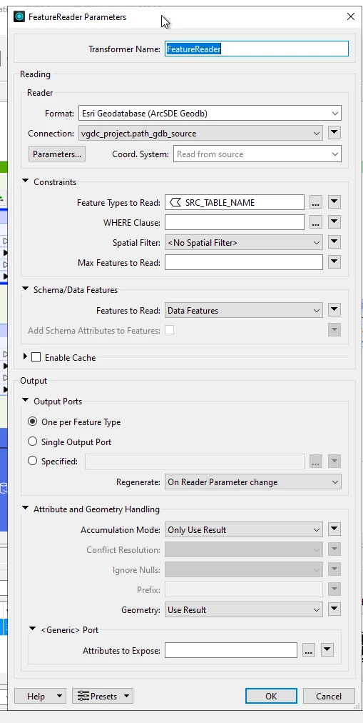

Hi everyone,
I’m running into an issue when using the FeatureReader transformer.
When I read a table through the FeatureReader, the attributes are not exposed  However, if I read the same table directly using a normal FME reader (through SDE or GDB), all the attributes are properly exposed.
Is there a setting I’m missing with the FeatureReader that prevents the attributes from being available? Or is this expected behavior when using it compared to a standard reader?

jugoslaviaa
Forum|alt.badge.img+6
  • Sep 24, 2025 11:15 AM UTC
​@virtualcitymatt This is how it looks
nielsgerrits
VIP
Forum|alt.badge.img+67
The features are leaving from the Generic port, this is why they are unexposed.

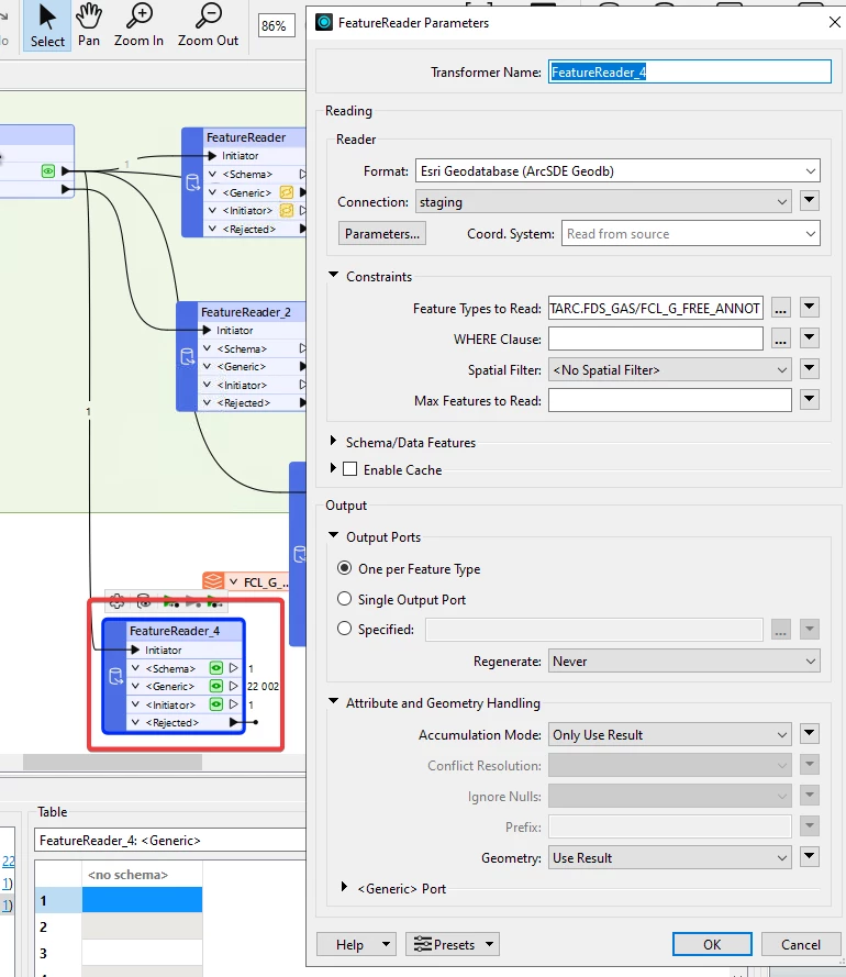

​@nielsgerrits I wanted to test your suggestion. I am selecting the dataset but it still sends to the generic port ‘

nielsgerrits
VIP
  • Sep 25, 2025 12:53 PM UTC
I think the steps are:
  • Set Regenerate to Parameter change. OK to apply.
  • Configure FeatureReader with a file, set one outputport per feature type, select feature types to read. OK to apply.
  • Set regenerate to Never. OK to apply.
  • Set dataset dynamic, the outputports will now stay as initially configured.
