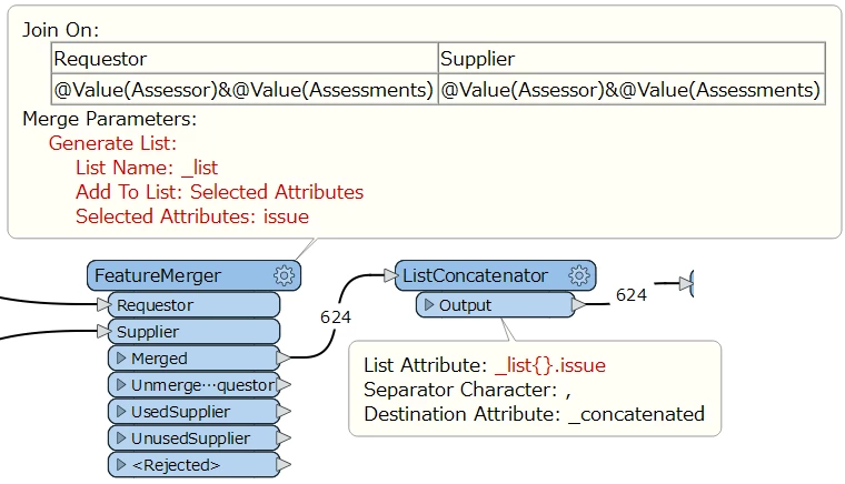

You can use the FeatureMerger to collect issues from all the matched suppliers for each requestor and store them into a list attribute, then concatenate every element of the list using the ListConcatenator. Does it fit to your requirement?

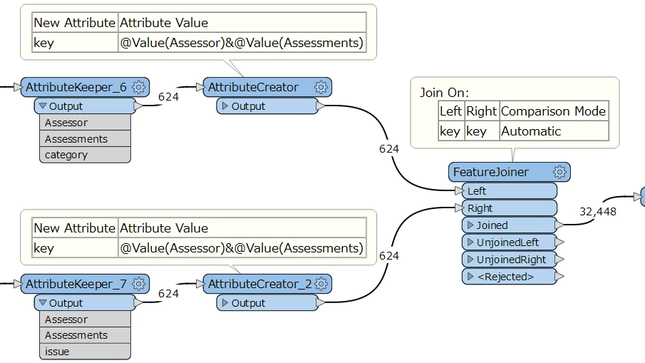

Hi @sbarn, the FeatureMerger merges a single supplier feature for each requestor feature. If you need to duplicate each requestor feature for every matched supplier, a possible way is to create a list attribute to save all the attributes from matched features and explode it with the ListExploder after. See the Generate List option in the FeatureMerger.
However, I think the FeatureJointer could be a better solution in your case, like this.
  • Nov 30, 2019 9:45 PM UTC
Hi @takashi thank-you for this. However I only want 624 rows returned. So I end up with columns Assessor, Assessment, Category and Issue returned for each row.
takashi
  • Nov 30, 2019 10:30 PM UTC
  • Dec 1, 2019 1:20 PM UTC
Brilliant @takashi , thank-you it worked a treat, also like your clear diagrams for me to follow.
