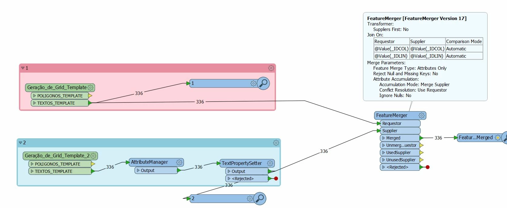

I tested you case in my machine and please - change transformer: FeatureJoiner to FeatureMerger like image bellow:

Hi Danilo,
It´s possible to control the side of the retrieve data and geometry in the Feature Merge like we do in the Feature Joiner ?
I´m asking that because i have a very particular case here: I need a "Left Joiner" and in case of conflict Resolution use "Right" data and left Geometry Handling ( because my "left" side is just a template to keep the table scale in the "pdf Page Formater" and my real data is in the Right side. So i need the data from one side, and the geometry from the other side.
It´s a bug in the feature Joiner ? I made another test, just puting a Attribute Manager after the joiners, and the original "fme_text_string" appears again like magic.

Yes its like a bug into this transform because i used it in others situation.
Immediatly could you use the transformer FeatureMerger?
