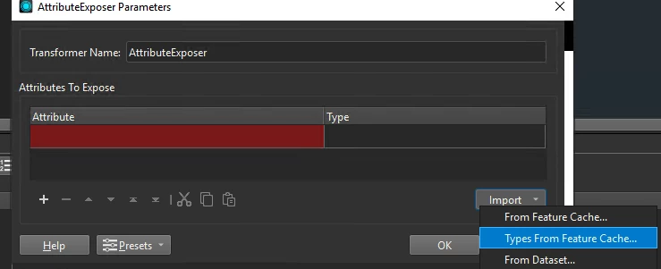

I have used a PythonCaller to flatten a xml dataset and have many handfulls of attributes that need to be exposed. Cutting and pasting into the AttributeExposer does not feel appealing. Surely there must be an easier way to do this? After all the features already have these attributes, only they are set to be Unexposed. It should be just a hide-unhide setting that is needed?

  • Nov 7, 2025 9:56 AM UTC
In the AttributeExposer you can add attributes from the FeatureCache, so if you’ve run it once, you can easily expose all hidden attributes. Ideally, it’d be great to have this functionality within the python caller (and other transformers, eg. JSON extractor) to avoid the additional AttributeExposer
