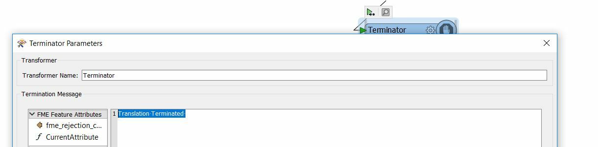

I meant the message one sets in the terminator, can it be extracted?
The message appears when terminated. Can I acces it?

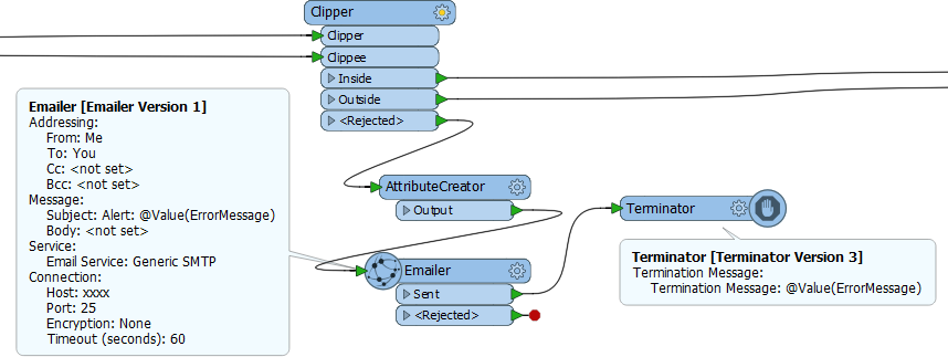

What you could do is add an AttributeCreator/Emailer just before the Terminator. Set the message and send out an email before anything gets terminated. And then you don't need to even set the message in the Terminator - just use the attribute in which you defined the message.
The nice thing then is that you can copy the Terminator anywhere in a workspace, and it will work fine, provided you use the same attribute name throughout.

Yes, ill simply use a creator to create a message and e-mail it (usually we do that trough batches). So I probably won't be using the terminator.
