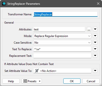

AttributeTrimmer only remove leading and trailing characters of an attribute.
https://docs.safe.com/fme/html/FME-Form-Documentation/FME-Transformers/Transformers/attributetrimmer.htm
It would be weird to use regex here.
Β
You might want to use the StringReplacer instead, which can use regex and replaceΒ with no character.

How about if I want to left trimΒ [^\w] down to nothing?

Yes, but left/right trim, not replacing in the middle of a string (which is what this would do, right?)

^ mean the start of the string
$ mean the end of the string
Β
^\w* litteraly translate to β€œall word characters (from 0 to x) at the beginning of the string”
alexbiz
Forum|alt.badge.img+35
  • Jun 23, 2025 1:52 PM UTC
So this is a left trim, it will not replace value in the middle of your value
Ah. Many thanks
