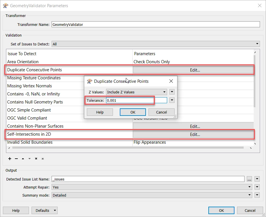

Hi @tfsrichard: Thanks for your question! The feature it's failing on is pid=7166521. When I filter out this feature, all remaining features (including all other multipart polygons) are written successfully to the SDE. So I'm thinking the issue isn't quite related to multipart polygons.
The feature pid=7166521 contains 6 extremely narrow polygon parts. I believe the issue sent back from the SDE is caused by your database/SDE tolerance (i.e. vertices that are snapped to a particular tolerance may result in self-intersecting and/or duplicate vertices that affect the resulting geometry).
For example, the following coordinates are four vertices from one of the parts of the offending feature. If the tolerance was set to 0.001, you will find that the three of these vertices would be identical:
  • 508493.5333573815, 5431015.562052546
  • 508500.625289657, 5431014.372179839
  • 508493.53359999973, 5431015.562
To confirm this train of thought, I tried passing pid=7166521 through a GeometryValidator and setting the Tolerance parameters for Duplicate Consecutive Points and Self-intersections in 2D to 0.001:
pid=7166521 comes out the GeometryValidator's Failed port as a self-intersecting 2D object.
