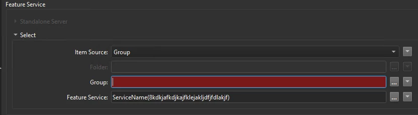

In the Esri ArcGIS Portal Feature Service I can reference a Feature Service in the parameters with the service name and an id
e.g.
But in the Esri ArcGIS Feature Service it’s not possible without a group? Is this correct?
Is there some secret syntax i’m missing?

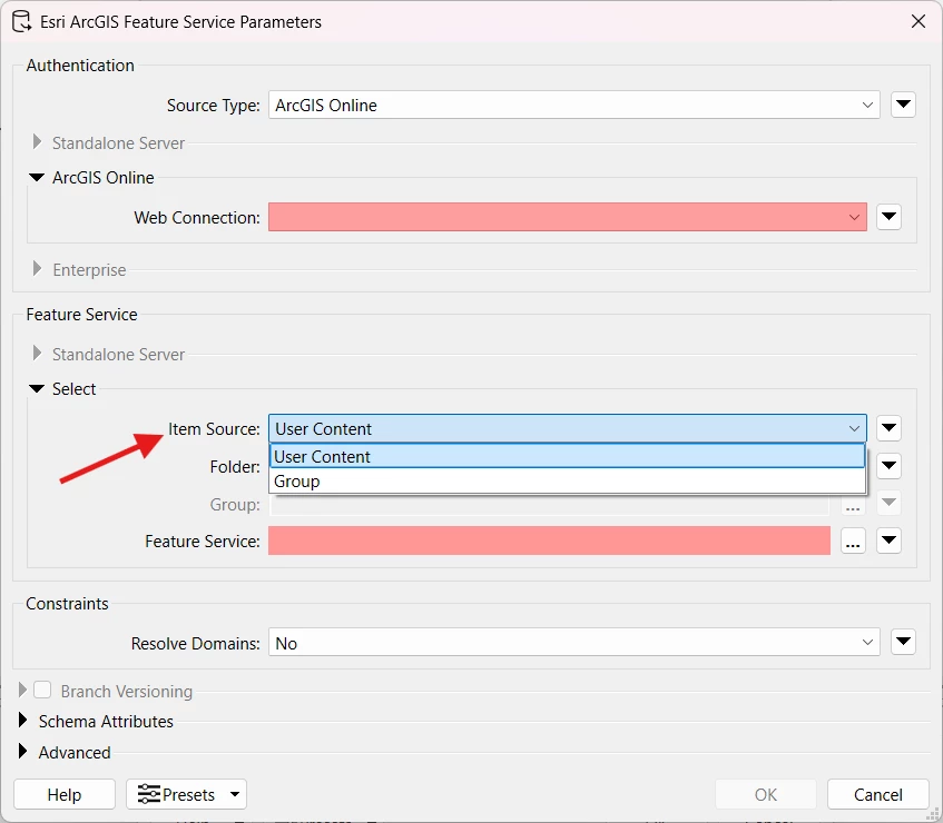

Yep. In the new ArcGIS Feature Service reader, make sure to select the Item Source first - either Group or User Content.
Once you do that, FME will list all services available under that source.

That’s not the issue, i want to reference a featureservice without reference to a group, which was possible in the existing reader.

I think this is a missing feature nowadays. When your source is AGOL, you need to select a group. This used to work perfectly. When using different software than FME it still does works.

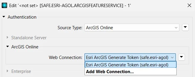

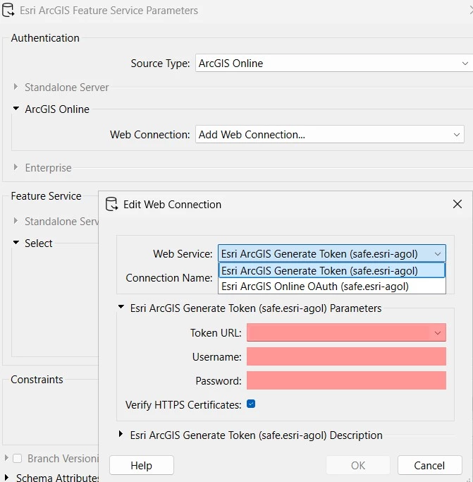

@nielsgerrits you can still use the generate token. Not really recommended for production deployment but for quick authoring, as you know. I don’t really like the user experience though.
Her’s the configuration.
Here’s the end result
Having Add Web Connection is for convenience, but I’m too skeptical since the Add Web Connection in the Feature Service formats can be confusing than keeping it in the Web Connections under FME Options, specially for beginners. WHen there were three separate formats it was fine, but when they were combined into one format, all of a sudden the list of web connections got longer - showing both the legacy and the new web connections of all feature services, in addition to the option adding more with this Add Web Connection feature from the format dialog.

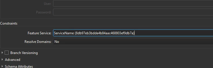

In the older reader, it was always the case that if you used the dialog to select a feature service the group name would be included,
e.g.
GroupName/ServiceName(89495c8ad7b346ecaf4358d757469fe0)
but this could be removed and using just
ServiceName(89495c8ad7b346ecaf4358d757469fe0) is possible
Additionally, it’s now the group id not the group name that is actually stored under the group parameter so it’s also an additional parameter that needs to be changed between environments. (Although does remove the risk of people changing group names and breaking FME workspaces!)

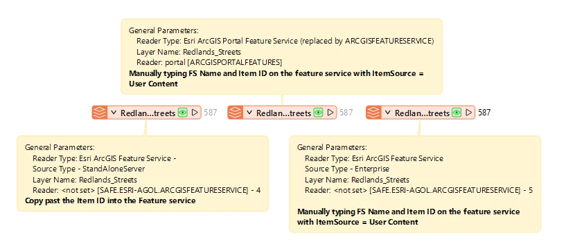

You can actually still do what you have even with the new format reader. Here’s the three ways I tested.

AI Assist’s response is to use the Standalone Server as the Source Type. Tested it and it works with the same environment. Not ideal but definitely a workaround to your migration ​@ebygomm .
  • Feb 3, 2026 12:28 PM UTC
Useful to know, thanks ​@salvaleonrp
Can confirm that it works for the service i’m interested in. (That’s with package 3.19.1 and Enterprise 11.5)
My preference will be to not actually upgrade to the newer writer at this time, it’s only in cases where we want to use some of the new functionality of the package, e.g. attachment connector to avoid having multiple web connections
