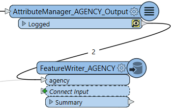

Flux:

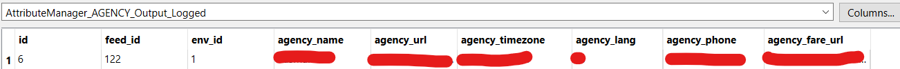

Data in logger:

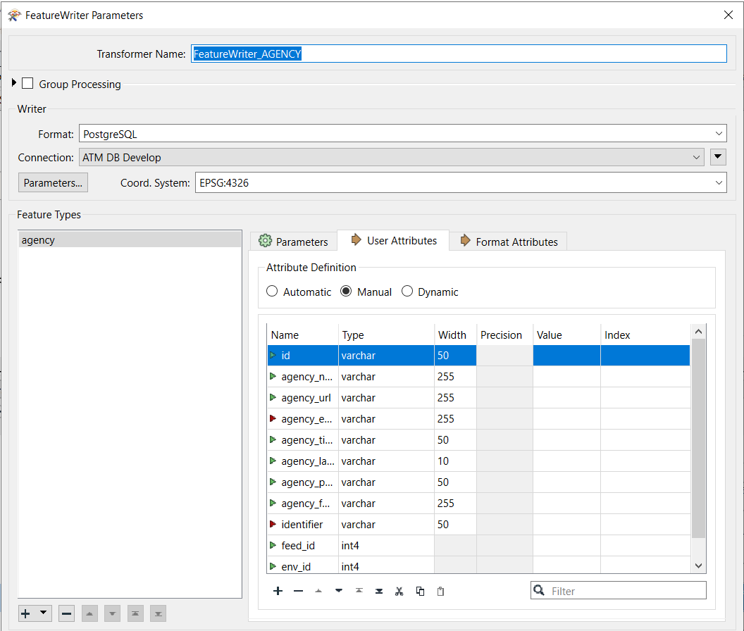

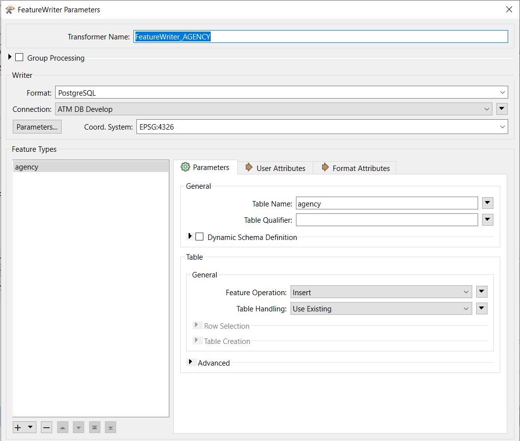

FeatureWriter Parameters:
FeatureWriter User Attributes:

Sorry we didn't get to your post in time! Based on the error message, it appears that id may have some missing values that aren't being included by the FeatureWriter to perform the insert, which is why PostgreSQL is reporting a “null value violates not null constraint” error. If you're still having trouble inserting to your PostgreSQL table, I believe it would be helpful to first distinguish if the id attribute is generated from in your workspace or brought in by a reader.
If id is created or modified within FME (for example, with an AttributeManager or Counter), please double-check that the attribute exists and all features have a value for it immediately before the FeatureWriter. You can do this by placing an Inspector or using feature caching at the writer input port.
If id originates from a reader, ensure that the reader exposes this attribute and that it hasn’t been filtered out or renamed during transformations.
As well, you could try importing the schema from the agency table in the FeatureWriter. Click the + at the bottom left > Import From Dataset > Parameters > Tables > agency.
