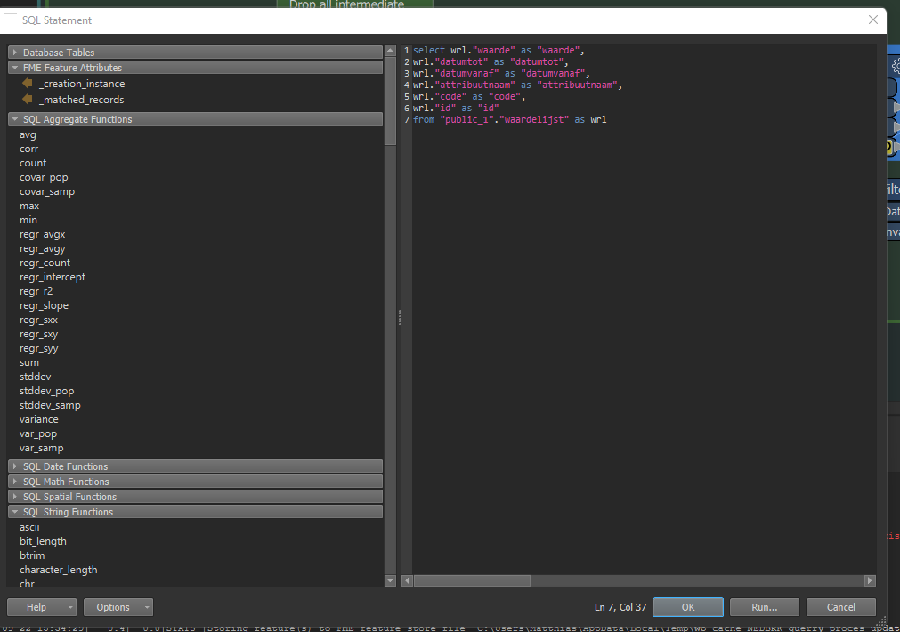

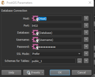

I have a workspace that reads a in a postgis database with an SQLExecutor. It all runs smooth.
However I want to make my workspace generic, so that it can use other input data from different databases/schemas in the future. That is why I put everything to read in user parameters. That being said I encountered the following problem.
My workspace runs fine with the original data. However when I change the name of the schema of my input data, and I change it in the SQL executor accordingly, I get the following error: 'Error executing SQL command ('select version(), postgis_version()'): 'ERROR: function postgis_version() does not exist'

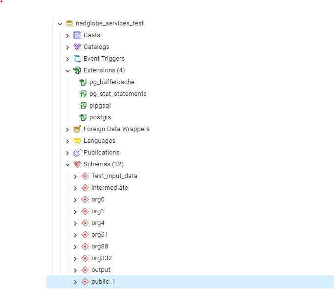

Most likely you haven't created PostGIS extension onto the database yet. Make sure that the database has the PostGIS extension with pgAdmin.
pgadmin-database-extensions" data-fileid="0694Q00000ACYb5QAHIf that's already been done, it sounds like grant issues. Make sure your user has sufficient rights.
To debug, try first to give the user full rights on the database schema. If that works, it's definitely a rights issue and you need to backtrack to find what's missing.
Another potential solution - updating the search_path for the user.

1) I have created a postgis extension. Like you can see in the screenshot I attached earlier. Essentially I'm also working from the same database and schema. The only thing I did is changed the name of the schema, and tried to read in the schema with a different name then public. There it went wrong.
2) I don't think it is a grant issue, because PUBLIC has access to read, write and usage. See image below. Moreover I just changed the name of the working schema public, and I didn't change any rights. Rights_schema
3) I don't have much experience with setting the search path. I tried some things, but nothing seem to work. However why would I have to search path again if I just change the name of a working schema?
