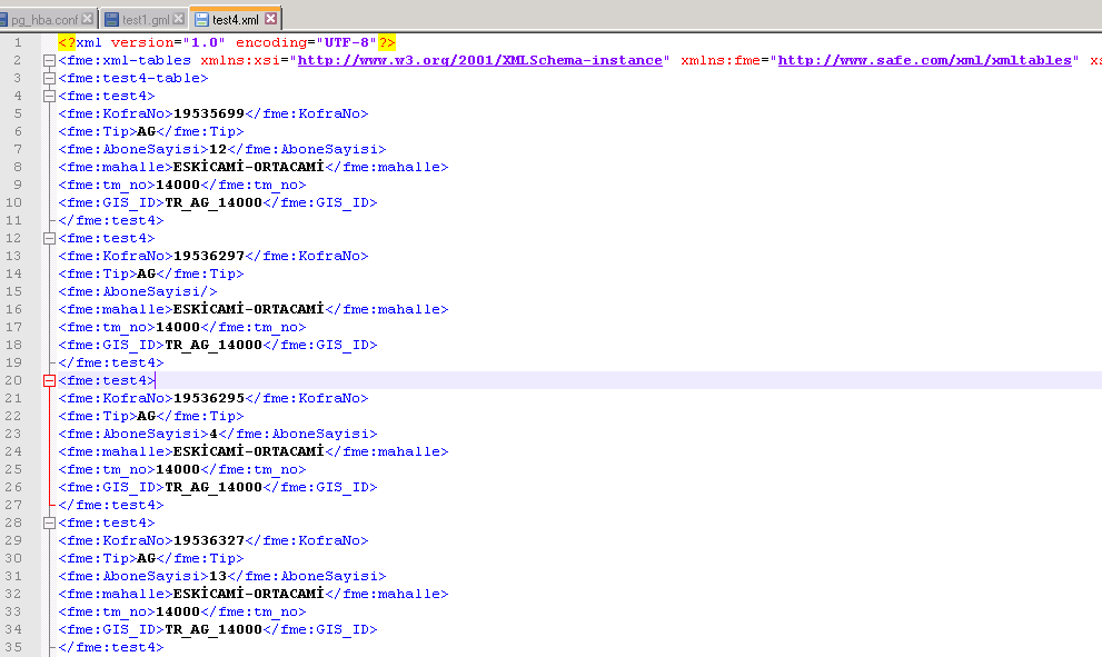

the orijinal xml result below

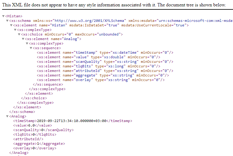

But I want to see as like below in the postman screen or in any explorer crome etc.
I mean that once it finished, I don't want to download the result, I want to see as xml directly on window looks as below
