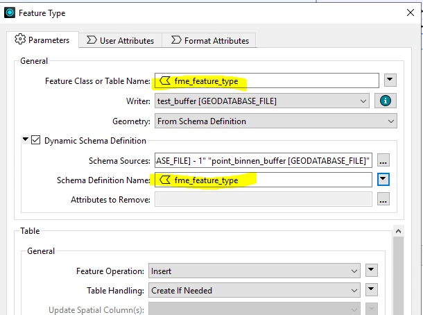

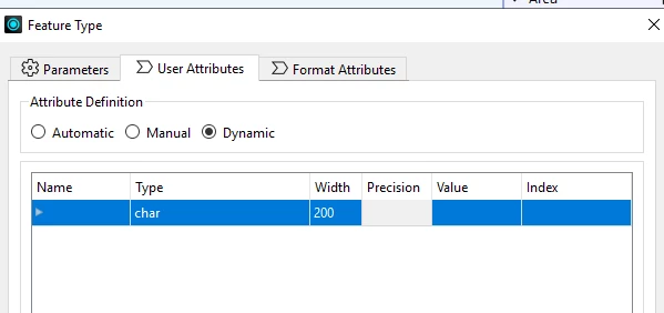

Hi ​@mitra
Have you selected “Dynamic Schema Definition” in Parameters tab and “Dynamic” in User Attributes tab in writer?

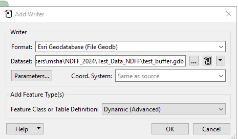

Yes, exactly. Moreover, I used a single merged feature type in the reader because my files were in File Geodatabase (FGDB) format, and all the feature classes were stored within one FGDB.
I ran the analysis using transformers and wanted to write the results for each feature class separately. To achieve this, I needed the output files in the writer to match the input feature classes from the reader, including their original names. Therefore, I used a dynamic writer.

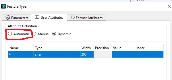

Why do you want to select “Dynamic” option when “Automatic” option will address your problem?
