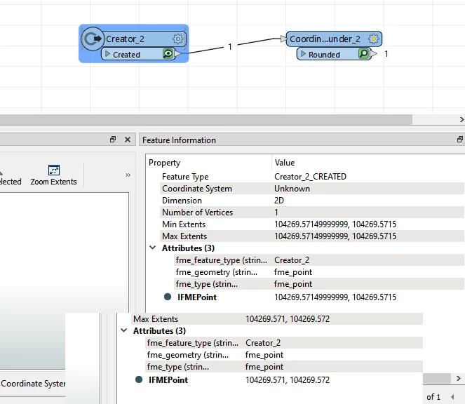

I believe it’s hitting a precision limit for geometry in FME, in testing I’m seeing it will round anything which is above 15 digits long.
Use a Creator, and paste in 104269.57149999999, inspect the feature created, you’ll see the coordinate precision in the geometry has been rounded. Try paste the full coordinate back in and remove 9’s until it stops being rounded.
It’s easier to see this if you instead try create an X coordinate of 1234567890.123456 (16 digits), which gets created as 1234567890.12346
So 104269.57149999999 is too long, instead of truncating the extra 9’s, it is being rounded when read into FME, turning it to 104269.5715. Then the CoordinateRounder is rounding to 104269.572
To ensure you always get the same result, you might have to read the geometry after applying ST_ReducePrecision, or read with that in a SQLExecutor.

That might not be your issue exactly - I actually stumbled on a regression with the Creator Version 6, the Creator is rounding the coordinates. It works fine in an older version of FME (2021)

I also used your example value of 104269.57149999999 in a coordinate, and using the coordinate rounder it gave me expected results. (104269.571)
Have you inspected the data directly before the CoordinateRounder?
The 499999 certainly seems like there’s some kind of floating point precision issue. Ironically the correct answer based on the original data would probably be 572. But of course consistency is important.
My guess is that somewhere along the way (probably in the reader) the value is getting rounded to 9 decimal places - this would result in the 5715 value, which in turn will get rounded up.
This is I think essentially echos what ​@ctredinnick said
