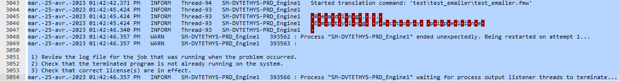

Hi @virtualcitymatt​ ,
My engine>current>fmeprocessmonitorengine.log give me that (cf image attached) when I test the emailer (creator + emailer).
In our installation it is a specific user that starts the FME Server services, so we are in the process of modifying the localization for this user to see if the emailer works once the setting is changed to English (Canada), as it does with our local use and FME Desktop.
Julian.

Ahh yeah, that's just a crash - my guess is that what you are attempting will fix the issue
