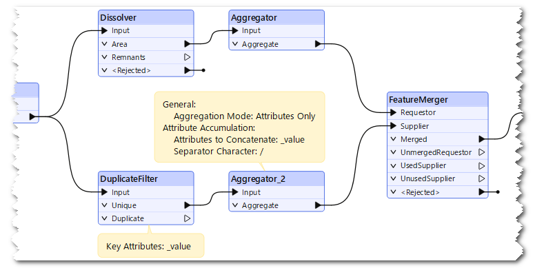

Hi ​@ebygomm ,
I don't know if you'd call it simple, a possible way I can think of is,
  1. Separate the data flow into two streams.
  2. On the first stream, process the polygons with Dissolver and Aggregator, without concatenating the attribute.
  3. On the second stream, remove dupliates on the attribute with DuplicateFilter and concatnate them with Aggregator.
  4. Finally, merge the concatenated attribute to the feature processed in the first stream.
4 replies
takashi
  • Jun 4, 2025 3:58 AM UTC
Hi ​@ebygomm ,

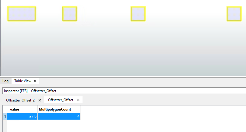

  • Jun 4, 2025 6:54 AM UTC
Certainly, simpler than anything I’d have thought of, I have 5 separate streams I’m already dissolving and aggregating so I think I’m going to stick with my python solution for this which is building two lists and then combining, deduplicating and concatenating. But I knew there should be a more straightforward FME way but I was getting hung up on lists

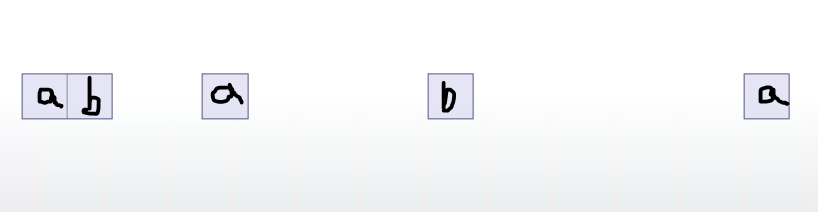

I'm afraid that your solution could cause unexpected result, if the data flow consists of Dissolver, Aggregator, and PythonCaller connected in series.
For example, in the case of this screenshot,
after dissolving, resulting features will have these attributes.
  • feature 1
    • Value = 'a'
    • dissolve{0}.Value = 'a'
    • dissolve{1}.Value = 'b'
  • feature 2
    • Value = 'c'
    • dissolve{0}.Value = 'c'
    • dissolve{1}.Value = 'd'
  • feature 3
    • Value = 'a'
Then, if you perform aggregating them with Aggregator, resulting feature will have these attributes.
  • feature
    • Value = 'a'
    • aggregate{0}.Value = 'a'
    • aggregate{1}.Value = 'c'
    • aggregate{2}.Value = 'a'
The value 'd' is missing.
