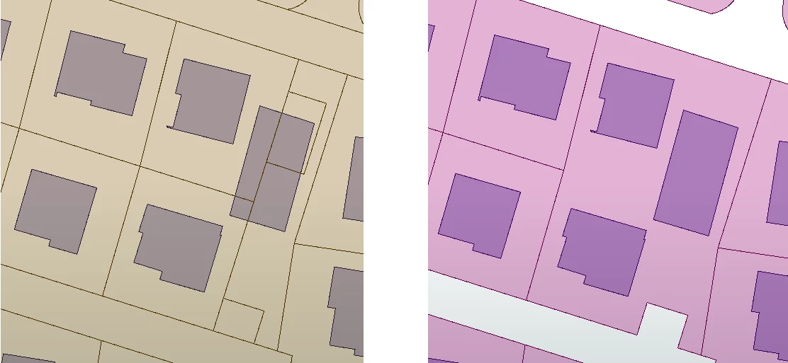

Hello, I have the following problem and hope you can give me a tip.
For a statistical analysis of my city, I have to know how much building space is on a landparcel. For this I have a source with the parcels and one for the buildings. I wanted to solve the problem with the AreaOnAreaOverlayer Transformer. Now I have the problem that some buildings are on more than one parcel. In this case, the common parcels must be merged and all buildings identified.

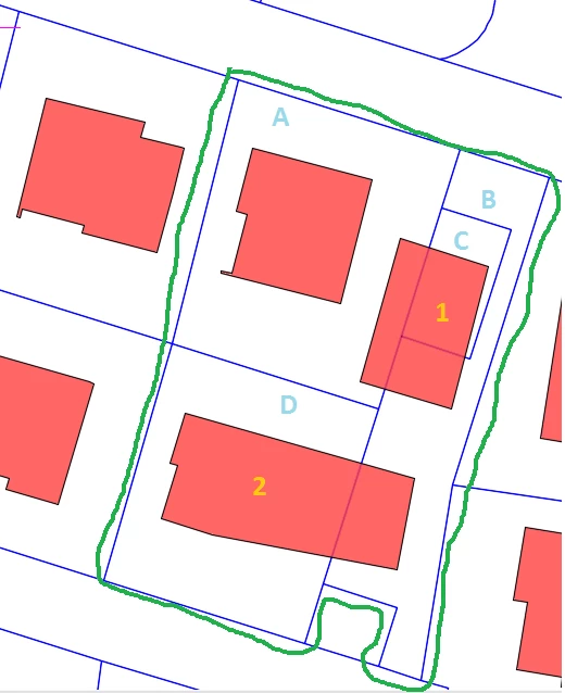

Here's an example:
The Buildung 1 is located on the parcels A,B,C. Buildung 2 is located on the parcels B,D.
At the end the parcels A,B,C,D must be dissolved.
When i use the AreaOnAreaOverlayer with Buildings and Landparcels, i have a lot of areaparts with several combinations of building and parcel-ID. When i start to dissolve the areas again with the id of one common building, i loose IDs of the others.
Please can you give me a tip how this problem can be solved? Thanks, David

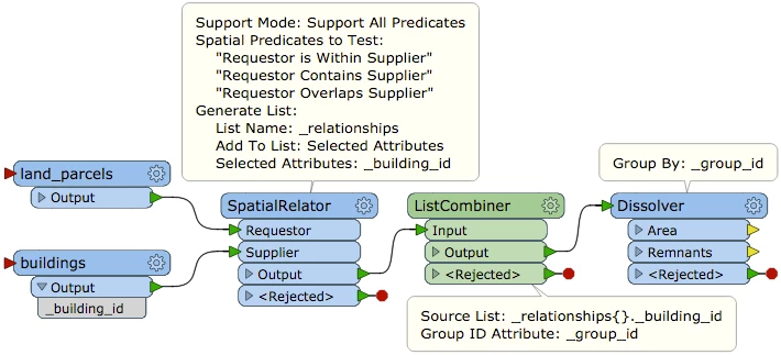

Best answer by takashi
If I understood the requirement correctly, the ListCombiner (from FME Hub) in this context might help you.

My problem is that if a building overlaps several parcels, i have to calculate the metric for all buildings on all affected parcels. So I have to dissolve the green marked area in my example.
I'm not quite sure I understand exactly what you need. Did you try the Clipper method and what was it about it that didn't meed your requirements?
Forum|alt.badge.img
  • Jul 17, 2018 5:51 AM UTC
Thank you, takashi and david. The solution of takashi is exactly what i need. That helped me alot.
