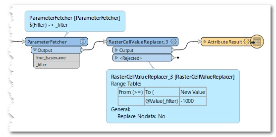

I'm doing a relatively simple task using a RasterCellValueReplacer, im filtering a few rasters by a defined filter parameter.
However, if the filter value is typed into the transformer it works fine, if i try and pass the filter value by either user parameter or attribute the result is completely different and incorrect.
What's a bit more of a concern, when i use an attribute or a parameter, the process seems to be making its own filter value out of thin air, the raster passes through as if filtered randomly

Thank you for sharing the workspace example and the sample dataset. I was able to the issur with FME 2023.2, 2024.2, and 2025.1. It seems to be a bug in some condition, but I couldn’t specify the exact cause.
I would recommend you to submit a support request to Safe.
Interestingy, I found that the issue won’t appear if you assing the user parameter value to a feature attribute with ParameterFetcher - not with AttributeManager and set the attribute to the filter parameter in RasterCellValueReplacer. This might be a workaround in the interim.
