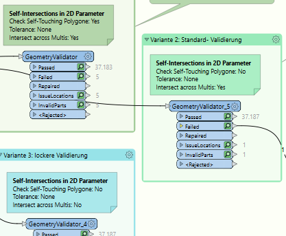

I am facing the problem mentioned in the title, especially when I want to detect Self-Intersections in 2D. FME detects a lot more Self-Intersections while PostGIS is fine with the geometry.
What are the reasons?
As we want to build up a standard quality gate for our data, I need to be certain that both ways - either using PostGIS or FME - act in the same way. What is the configuration then for FME to match the behaviour of PostGIS’s ST_IsValid function?

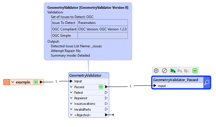

What settings are you using in the GeometryValidator - OGC should be close to PostGIS ST_IsValid?
Do you have an example of a geometry that FME reports as having self intersections but reports as valid in PostGIS?

I tried different settings (see screenshot). I attached one example. :-)
  • May 23, 2025 1:36 PM UTC
That will pass a check if you’re checking OGC which is what ST_IsValid is checking so the result in FME is consistent with ST_IsValid
The OGC standard considers duplicate consecutive points to be valid, FME reports them as self intersections *if* you are specifically looking for self intersections
