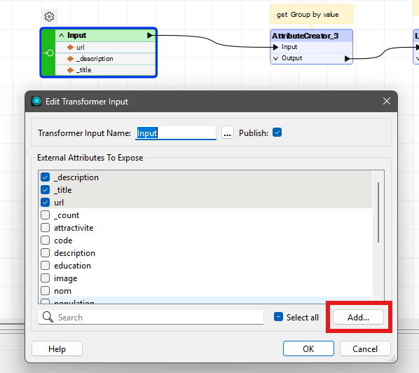

OOOOw You just made me realize one of my struggle
I’ve developed the good habit of, whenever I need to create parameters that should be at least partly driven by attributes, managing them directly in the custom transformer’s ‘Input’ entry.
Those added attributes will create text user parameters that would work every time, I know why now.
