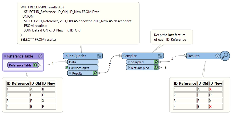

I would let FME process the Reference table, so it turns
A → B, C → D, B → X
into
A → X, B → X, C → D
This can be done with an InlineQuerier, using recursive SQL.
This can also process more difficult situations (which you probably have):
A → B, C → D, F → X, B → F will become A → X, B → X, C → D, F → X
SQL query in the Inline Querier:
WITH RECURSIVE results AS (
    SELECT ID_Reference, ID_Old, ID_New FROM Data
  UNION
    SELECT c.ID_Reference, c.ID_Old AS ancestor, d.ID_New AS descendant
    FROM results c
    JOIN Data d ON c.ID_New = d.ID_Old
SELECT * FROM results;
See the example in the attached workspace (FME Form 2023.1)

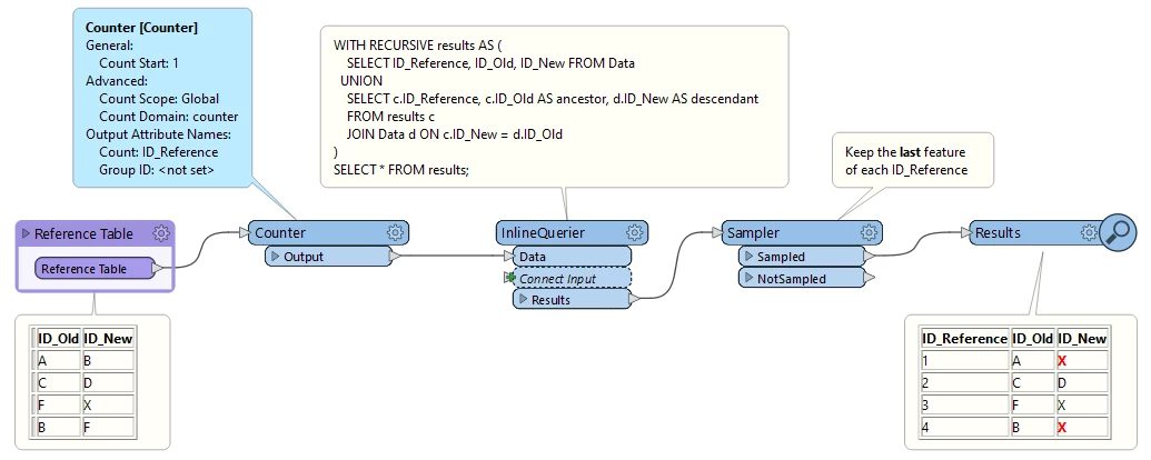

My example workspace only processes the reference table. It does need a unique indentifier in the Sampler, but if your table doesn't contain such an attribute you can add it.
You should be able to enter the SQL I provided in your own InlineQuerier in FME 2022.

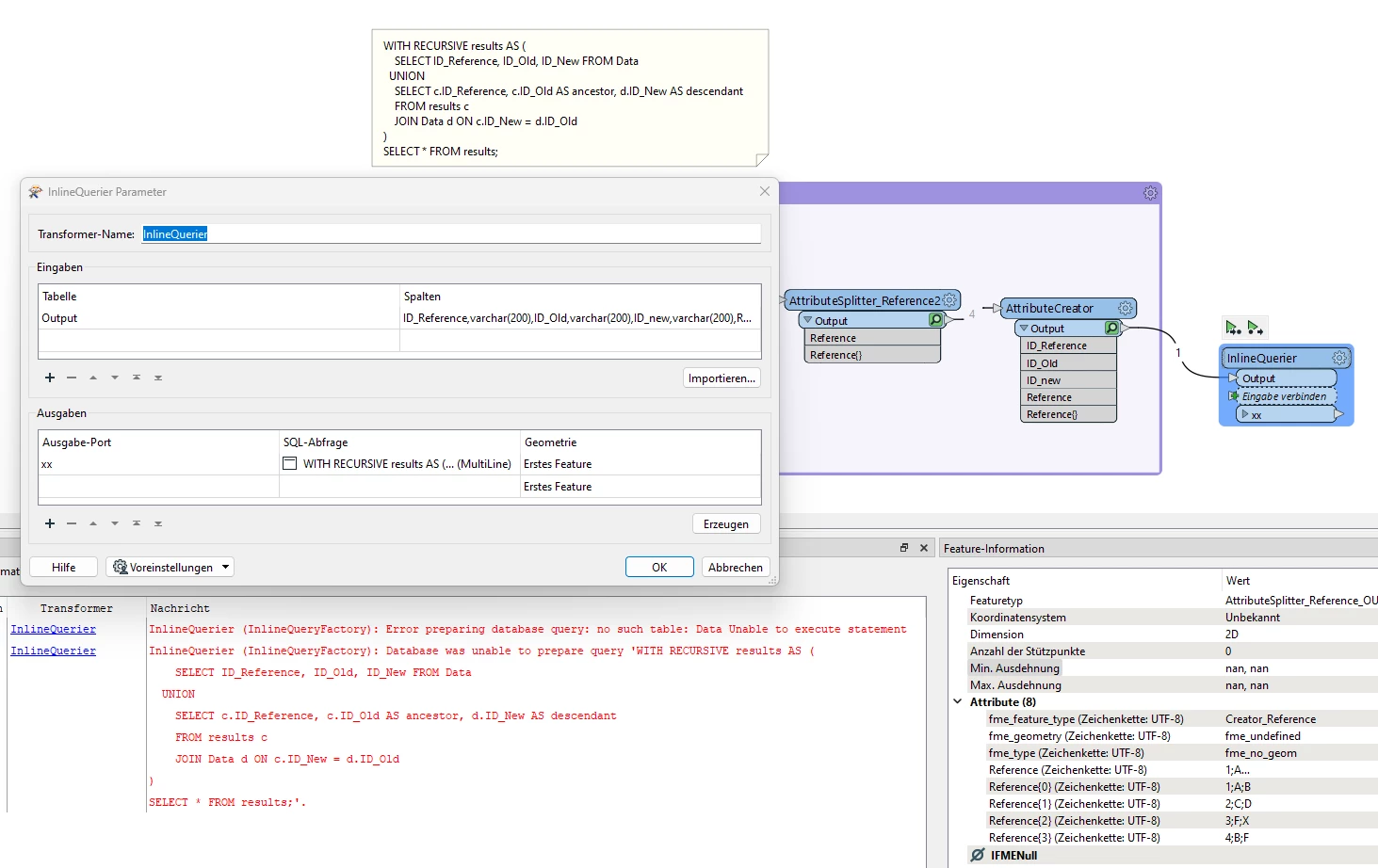

I tried to use InlineQuerier, but I get an error message (see image).
About the sampler: I don't understand. You write that the sampler needs a unique ID. I don't have one, so I can't add it and generate an artificial key in advance? That doesn't make sense to me.
All I need is a loop that runs through a bookmark (that's my Customer Transformer) multiple times. The control should (ideally) be done via VariableSetter and VariableRetriever. That's all. If necessary, I could use a user parameter to determine how often the loop should run.
Thank you.

Hi fbeginner,
No problem.
Try changing Output under Tabelle into Data.
Maybe I should have added a screenshot of the settings of the InlineQuerier.

  • Dec 2, 2025 7:25 AM UTC
As for the unique ID, you can use a Counter to create one.
fbeginner
Forum|alt.badge.img+4
  • Dec 2, 2025 7:41 AM UTC
Wow, that's the solution, thank you very much.

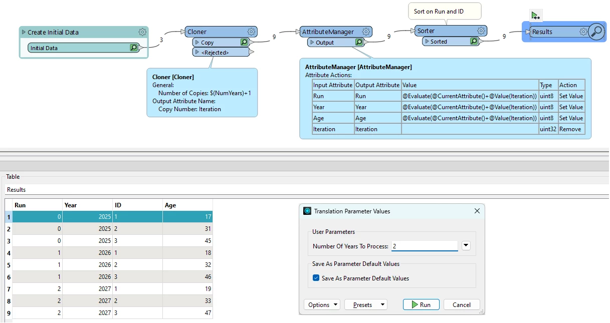

Why make it so difficult?
This can easily be done without a custom transformer and without using a VariableSetter / VariableRetriever duo; just use a Cloner and an AttributeManager. And for flexibility use a UserParameter for the number of years to process.
Custom transformers, VariableSetter and VariableRetriever certainly are interesting elements of FME, but  they are completely unneccessary here.

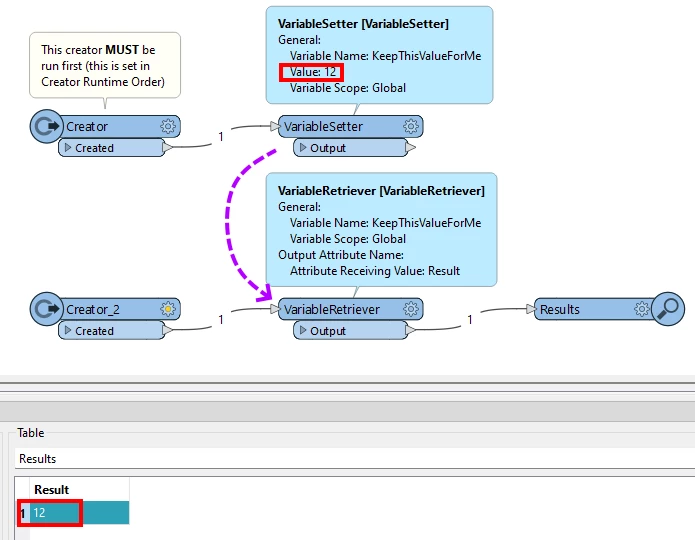

With VariableSetter you can keep one value, and use it later in the workspace. The VariableRetriever can get that value later on. But there is a catch: the VariableSetter MUST be processed before the VariableRetriever. In the example below the value is transferred from one flow to another.
I have learned you need to be very careful when using VariableSetter and VariableRetriever. It is very possible that the VariableRetriever is processed before the value is set in the VariableSetter. And in that case the value will not be (and can not be) read by the VariableRetriever. Therefore I don't like using them in complex workspaces.
