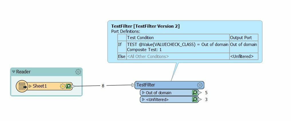

I used the transformer TestFilter to filter the fisrt condition:
Thanks in Advance,
Thanks in Advance,
Danilo
Thanks! I got it. See my answer above.
