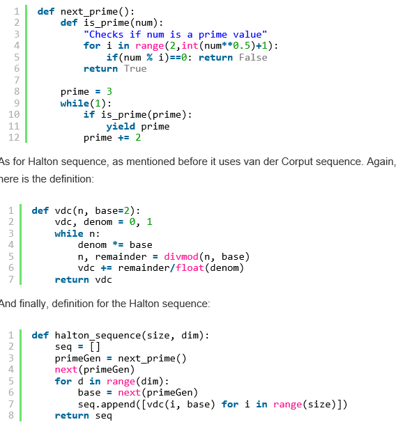

Dear community,
I would like to create a halton sequence meaning systematic random distributed points. I found the appended python code. To call it: halton_sequence(
10
3
 Now, how can I adapt the code so I can use it in the PythonCreator? I would need a list of coordinates to create the points.
Thank you for your help!
Best answer by david_r
Try the following in a PythonCreator:
import fmeobjects
def next_prime():
  Â  def is_prime(num):
  Â  Â  Â  "Checks if num is a prime value"
  Â  Â  Â  for i in range(2,int(num**0.5)+1):
  Â  Â  Â  Â  Â  if(num % i)==0: return False
  Â  Â  Â  return True
  Â  prime = 3
  Â  while(1):
  Â  Â  Â  if is_prime(prime):
  Â  Â  Â  Â  Â  yield prime
  Â  Â  Â  prime += 2
def vdc(n, base=2):
  Â  vdc, denom = 0, 1
  Â  while n:
  Â  Â  Â  denom *= base
  Â  Â  Â  n, remainder = divmod(n, base)
  Â  Â  Â  vdc += remainder/float(denom)
  Â  return vdc
def halton_sequence(size, dim):
  Â  seq = []
  Â  primeGen = next_prime()
  Â  next(primeGen)
  Â  for d in range(dim):
  Â  Â  Â  base = next(primeGen)
  Â  Â  Â  seq.append([vdc(i, base) for i in range(size)])
  Â  return seq
class FeatureCreator(object):
  Â  def __init__(self):
  Â  Â  Â  pass Â # Do nothing
  Â  def input(self,feature):
  Â  Â  Â  # Initialize the sequence
  Â  Â  Â  size = int(FME_MacroValues['HALTON_SIZE'])
  Â  Â  Â  dim = int(FME_MacroValues['HALTON_DIMENSION'])
  Â  Â  Â  halton = halton_sequence(size, dim)
  Â  Â  Â  if dim == 2:
  Â  Â  Â  Â  Â  halton_points = zip(halton[0], halton[1])
  Â  Â  Â  elif dim == 3:
  Â  Â  Â  Â  Â  halton_points = zip(halton[0], halton[1], halton[2])
  Â  Â  Â  else:
  Â  Â  Â  Â  Â  raise IndexError('Only 2 or 3 dimensions are supported')
  Â  Â  Â  for elem in halton_points:
  Â  Â  Â  Â  Â  newFeature = fmeobjects.FMEFeature()
  Â  Â  Â  Â  Â  if dim == 2:
  Â  Â  Â  Â  Â  Â  Â  newFeature.setDimension(fmeobjects.FME_TWO_D)
  Â  Â  Â  Â  Â  else:
  Â  Â  Â  Â  Â  Â  Â  newFeature.setDimension(fmeobjects.FME_THREE_D)
  Â  Â  Â  Â  Â  newFeature.addCoordinate(*elem)
  Â  Â  Â  Â  Â  self.pyoutput(newFeature)
  Â  def close(self):
You'll have to create the two published parameters HALTON_SIZE and HALTON_DIMENSION in your workspace. The output will be either a number (HALTON_SIZE) points of either 2D or 3D points.

Next time, please consider either using a code block or giving the URL to source of the code so that we can copy/paste it rather than type from images :-)

This works perfectly. Thank you very much!
