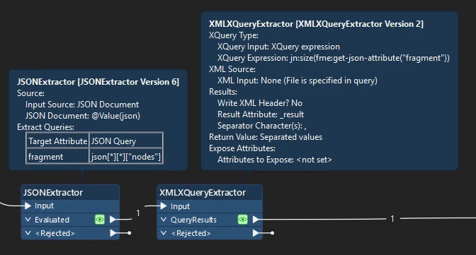

  • Feb 5, 2026 10:12 AM UTC
You can do this in an XMLXQueryExtractor which I think is non blocking
e.g. if your json looks like this
"id" : 1,
"data" : [
{"x" : 1},
{"x" : 2},
{"x" : 3},
{"x" : 4}
You can do something like this to get the size of the array
jn:size(fme:get-json-attribute("json")("data"))
lifalin2016
Forum|alt.badge.img+42
  • Feb 5, 2026 11:04 AM UTC
Thanks ​@ebygomm
It looks promising.
My array JSON query is: json[*][*][“nodes”]
How would that be expressed in XQuery ?

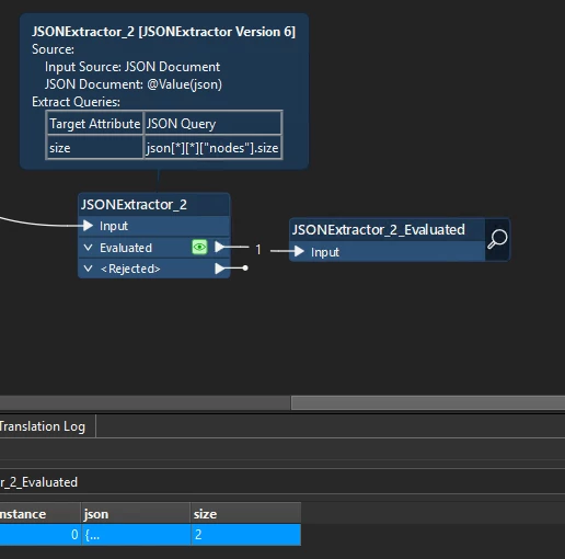

  • Feb 5, 2026 7:03 PM UTC
Can you try it in the json extractor/fragmentor with .size? Like this : json[*][*][“nodes”].size
I found this in the json query section of the fragmenter:
JSON Property Expressions
A property expression is a structure expression as described above, followed by a . (dot) operator and a property name. Currently, the only supported properties are type and size. The type property returns the type of the JSON value referred to by the JSON structure expression. For example, if the outermost JSON element is an array, and the first element of the array is a string, then the expression json[0].type would have a value of string. The size property, which can only be applied to an array, returns the number of elements in the array.
So the .size sounds like what you need.
  • Feb 5, 2026 9:02 PM UTC
Nice!
itsmatt
Forum|alt.badge.img+48
  • Feb 6, 2026 7:10 AM UTC
Winner winner chicken dinner!
