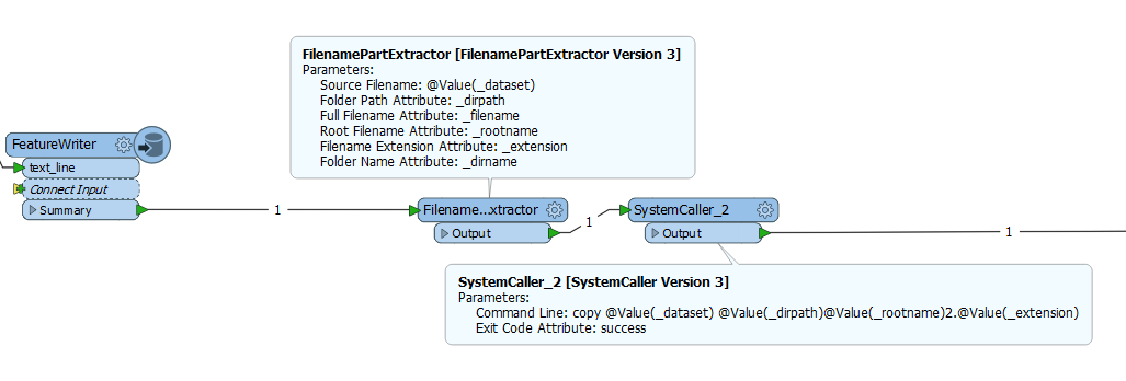

Hi,
The systemCaller give me that answer in the log :
SystemCaller: Executing `copy /Y C:\\Livraison AIXM 51 V2.0\\01 - Ecriture_mid_uuid/test.xlsx C:\\Livraison AIXM 51 V2.0\\01 - Ecriture_mid_uuid/tst2.xlsx'
2018-07-25 14:16:58| 17.1| 0.0|WARN |SystemCaller: Failed to Execute `copy /Y C:\\Livraison AIXM 51 V2.0\\01 - Ecriture_mid_uuid/test.xlsx C:\\Livraison AIXM 51 V2.0\\01 - Ecriture_mid_uuid/tst2.xlsx'
probably it doesn't succeed to write because it's a "/" and it needs a "\\" before "tst2.xlsx"
Forum|alt.badge.img
  • Jul 25, 2018 1:06 PM UTC
Please have a look to my picture to understand where is the issue:
I suceed by the "attributecreator" way to copy "test.xlsx" into "tst2.xlsx" using a private attribute "dir" which is obtained with a python script
and here is the log for this way
Why is it wrong with the systemcaller ???
This way allows to change the initial place of my global work. If i put the initial folder "Livraison AIXM 51 V2.0" containing all the subfolders in another folder (ie c:\\ or c:\\users\\desktop) it works
Why not with systemcaller ?

Try: copy "$(dir)\\test.xlsx" "$(dir)\\tst2.xlsx"
