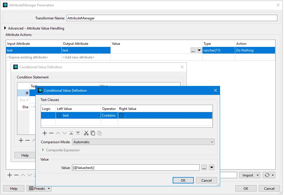

Please use a Tester to test if Attribute A contains a comma. Route the Passed output to a StringConcatenator to add the square brackets to the beginning and end of the attribute value.
You could also do the same operation using a conditional operation in an AttributeManager:
