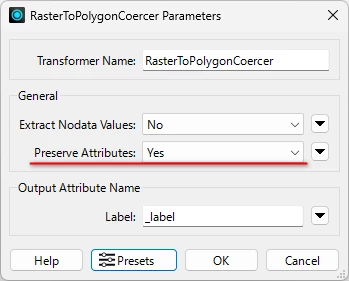

Have you tried setting ‘Yes’ to the Preserve Attributes parameter in the RasterToPolygonCoercer?

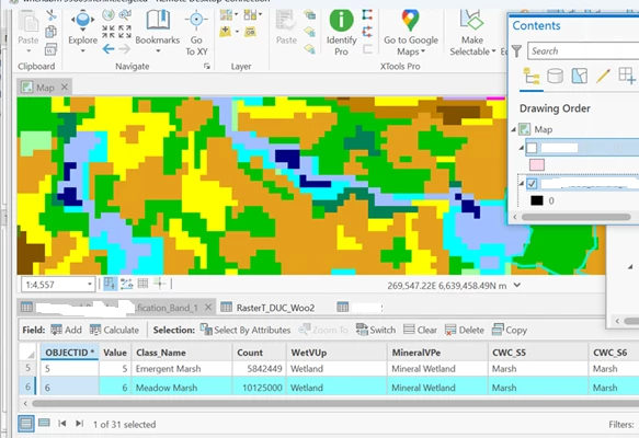

​@takashi  yes I used that setting. the issue is that the Raster.gdb (with 31 records and no Length or Area fields) is for multiple parcels (ie. 1 type  has 250 locations in 1 record)
so i need to find a way to explode the Raster dataset so each location is a different record

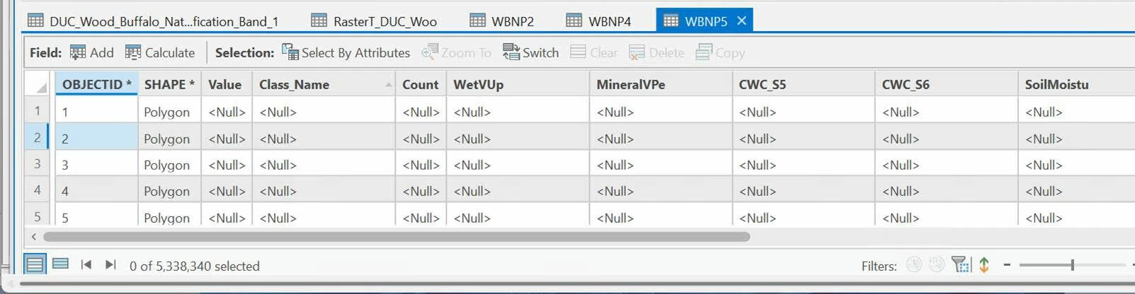

the result after running RasterToPolygonCoercer is 5,338,340 records, but every record is unpopulated with data
curtisd54
Forum|alt.badge.img+5
  • Sep 29, 2025 1:50 PM UTC
for example OBJECTID 6 - has multiple parcels that I want with the same values but in different records

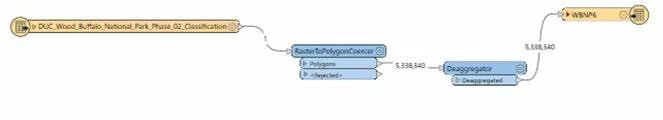

Have you tried the Deaggregator?
curtisd54
  • Sep 29, 2025 2:49 PM UTC
so use DeAggregator before using RasterToPolygonCoercer ?
geomancer
Forum|alt.badge.img+71
  • Sep 29, 2025 2:51 PM UTC
No, afterwards.
curtisd54
  • Oct 1, 2025 4:26 PM UTC

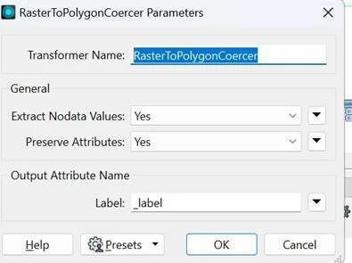

​@geomancer  i used RasterToPolygonCoercer then DeAggregator  but still get  5,338,340 records, but every record is unpopulated with data (NULL)
is there any specific settings i should use ??
I have extract NOdata Values - NO and  Preserve Attributes to YES for RasterToPolygonCoercer
for DeAggregator i used  Mode :Flatten One Level , Split Composities NO and Explode Instances - NO
thanks!

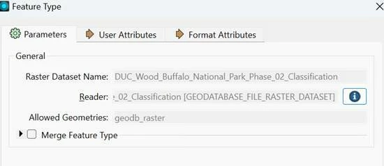

0?ui=2&ik=44664ef3f8&attid=0.1&permmsgid=msg-f:1844886780537139278&th=199a5ac094baf04e&view=fimg&fur=ip&permmsgid=msg-f:1844886780537139278&sz=s0-l75-ft&attbid=ANGjdJ-lviV8Fc14TSN8LscDVjBOk6xN6ifkStPzveG02m0nlfYnq2Wf_Bn4QvNBmeZ01Zb_SRhmmJJ-jRfaWjGZOE4JEK4U36ZPV5ph4LmpPFN79cDKJOPcNaaHbf8&disp=emb&zw
Data table (File Geodatabase Raster -Band) before:
0?ui=2&ik=44664ef3f8&attid=0.2&permmsgid=msg-f:1844886780537139278&th=199a5ac094baf04e&view=fimg&fur=ip&permmsgid=msg-f:1844886780537139278&sz=s0-l75-ft&attbid=ANGjdJ8SQajXxQwJJnJ1jBiiUaLaPIxye4OWzbKAGiMakthu66Bv6DkVFQexDp_wCQEOSK-W8hBQmSM7IkQM8uBbTzmUHTfak7qNBTGTFN8natnB8aNhvQclCFwubhU&disp=emb&zw
FME Feature Type:
0?ui=2&ik=44664ef3f8&attid=0.3&permmsgid=msg-f:1844886780537139278&th=199a5ac094baf04e&view=fimg&fur=ip&permmsgid=msg-f:1844886780537139278&sz=s0-l75-ft&attbid=ANGjdJ89xqMpZgMO7LtdlTQFAiS0kaHt7ybHNxLLy-GZHhvDCQ6xBXGk6GYDMij02zKu0X1Nk16r4q7lzFO4TLHmlFVH2LHKBSt_ndiP7MDcghYeUOBf4xZWYM69RMs&disp=emb&zw
Attributes:
0?ui=2&ik=44664ef3f8&attid=0.4&permmsgid=msg-f:1844886780537139278&th=199a5ac094baf04e&view=fimg&fur=ip&permmsgid=msg-f:1844886780537139278&sz=s0-l75-ft&attbid=ANGjdJ-Mq3KNCxc7wcl769aMFI2L1zOtHyQEy9BOwRxZ2F4AJ4HKU1ZnidGDN52x0uVpUBo9j7zdS-tByZ8thWSHpA-8AWz5_y2rlI0TUqfZNud9HW7kqY04M2A3OYg&disp=emb&zw

takashi
  • Oct 2, 2025 8:38 PM UTC
I cannot see images for some reason. Could you please paste them again?
If you read the raster dataset again with Feature Caching on, try reading just a single record e.g. OBJECTID = 6 to save time.

i put them as attachments in this message, not sure why you cant see them above, they are embedded in the post . Yes i am re running using a sample of the dataset
thanks!

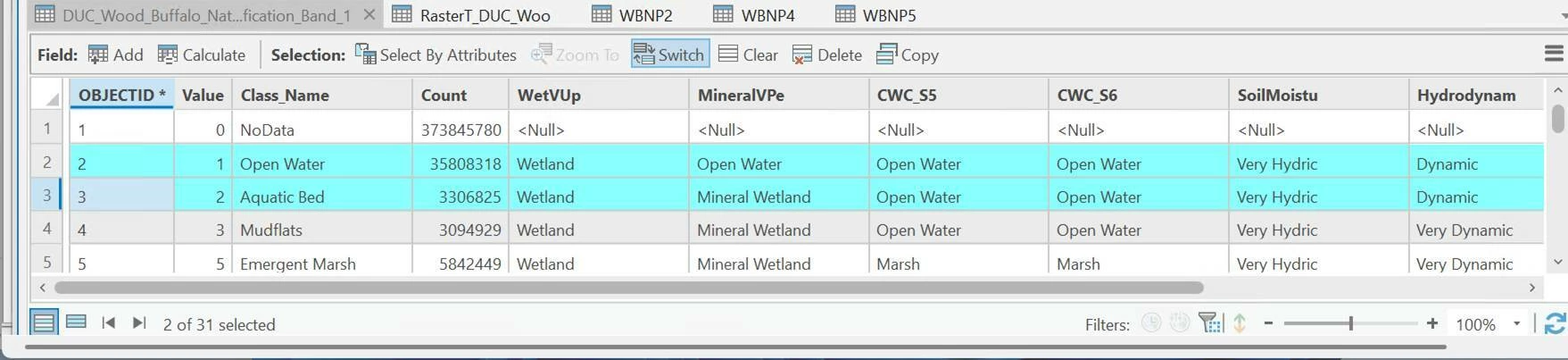

It seems that each record of this table contain properties corresponding to a cell value in the raster, not attributes of the raster feature. If so, I think you could merge the properties to the extracted polygons, using “Value” (cell value) as key. FeatureMerger or FeatureJointer might help you to do that.

​@takashi an update we discovered this issue was fixed with advice from https://community.safe.com/general-10/how-to-expose-raster-attribute-values-26222?postid=148770#post148770
there was a bug in FME  previous versions before 2024  (Bug resolved in build 2024.0.24194 (FMEENGINE-77293) where raster attribute values were not being exposed.
i have my process working now. thanks!
