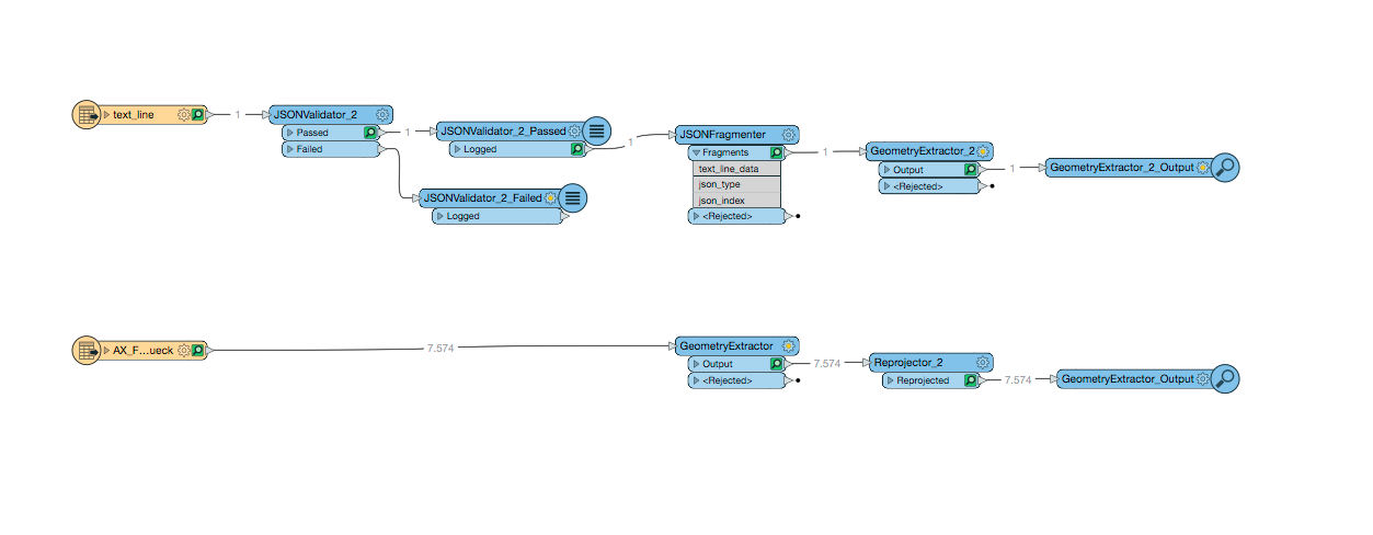

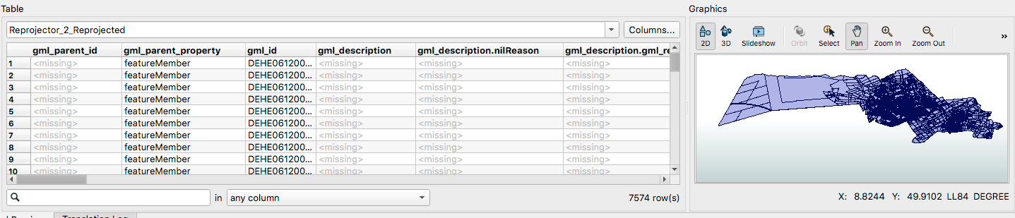

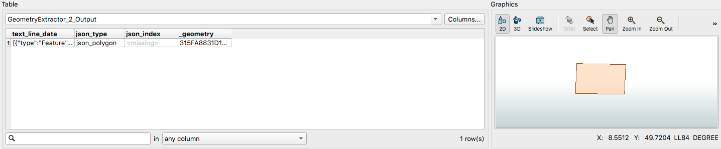

In the first picture you can see what i did so far, i parsed the geojson file and I extracted a geometry, in the second source i extracted the land parcels geometries and adapted the coordinate system (LL84). In the second and third picture you can see both the graphics, so it works very well. Now i should "only" compare the geometries and get the affected land parcels.
