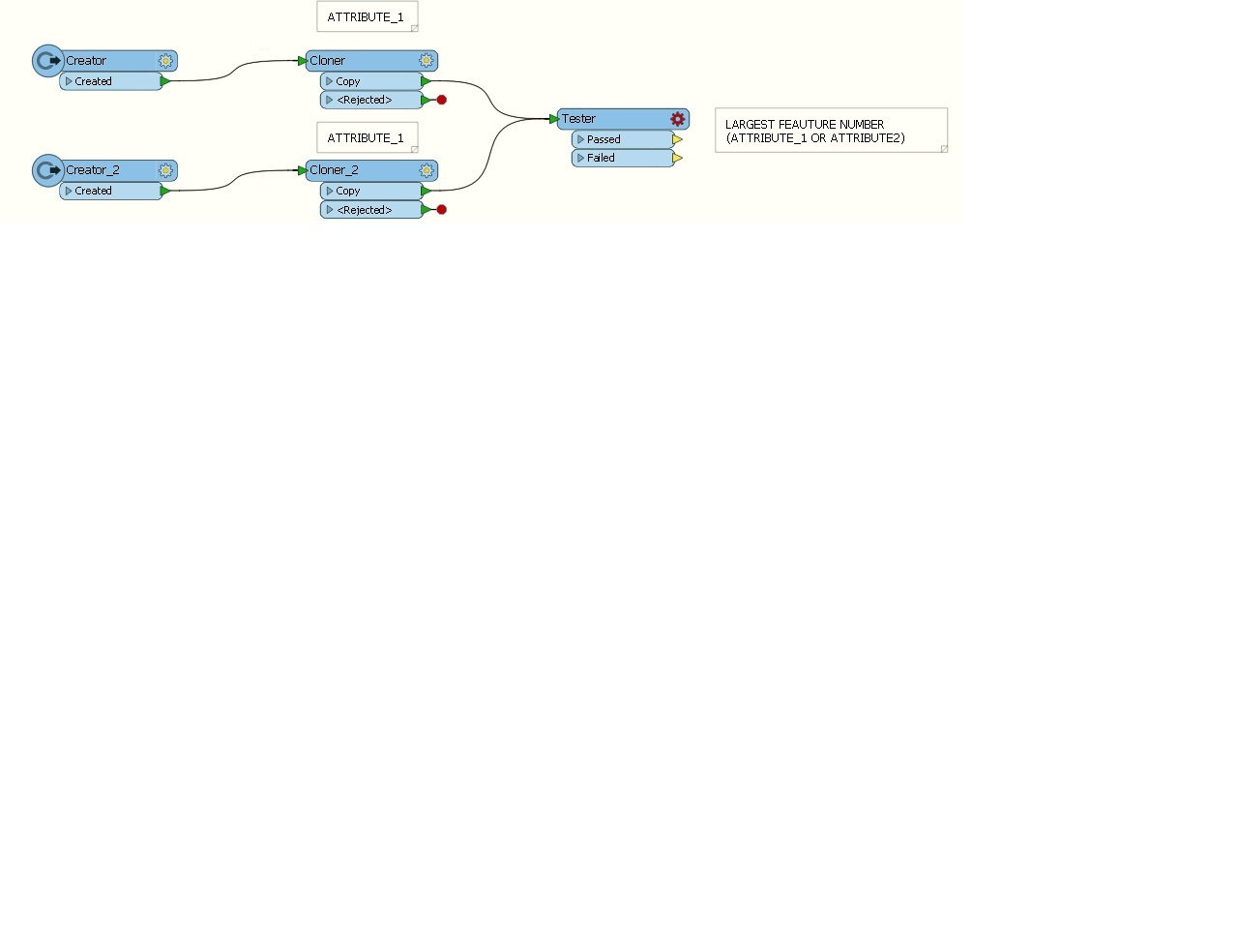

I have two data stream, both have count attribute. I would like to compare the count_1 and count_2, if the count_1 > count_2 the set attributes by count_1 go ahead...if count_2 > count_1 the set attributes by count_2 go ahead.

Let explain more clearly.
My workspace like this
I would like to filter so that the highest number of features always goes ahead. It´s possible!?

The Tester processes input features one by one, separately. That is, it can compares attribute values within a single feature, it cannot compare attribute values among different features.
I cannot understand your intention correctly from the screenshot, but if you need to select only features that have the max value in 'ATTRIBUTE_1', a possible way is: get the max value in 'ATTRIBUTE_1' with the StatisticsCalculator, merge the Summary feature from the StatisticsCalculator to the original features unconditionally, then test if 'ATTRIBUTE_1' is equal to the max value.

Looks like your looking for FeatureCounter, which counts all features in a stream, you can compare this to numbers of features in another stream.
