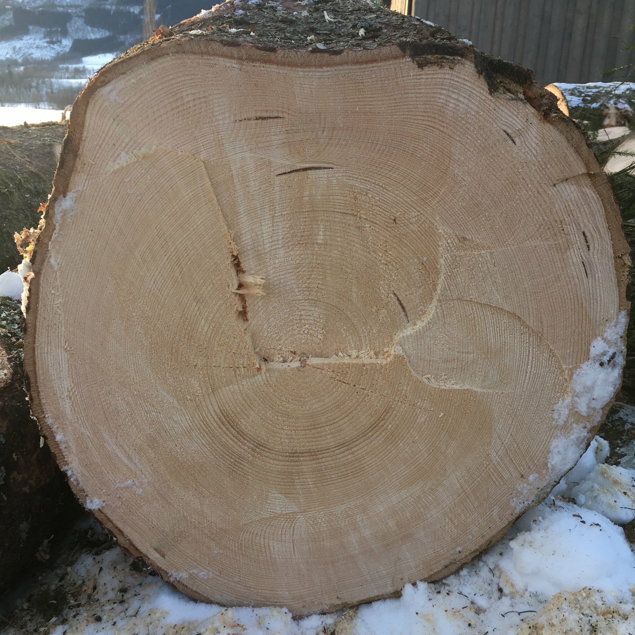

Is there a good way to calculate the age of this tree with FME? https://twitter.com/reisir/status/1091726774919196673?s=19

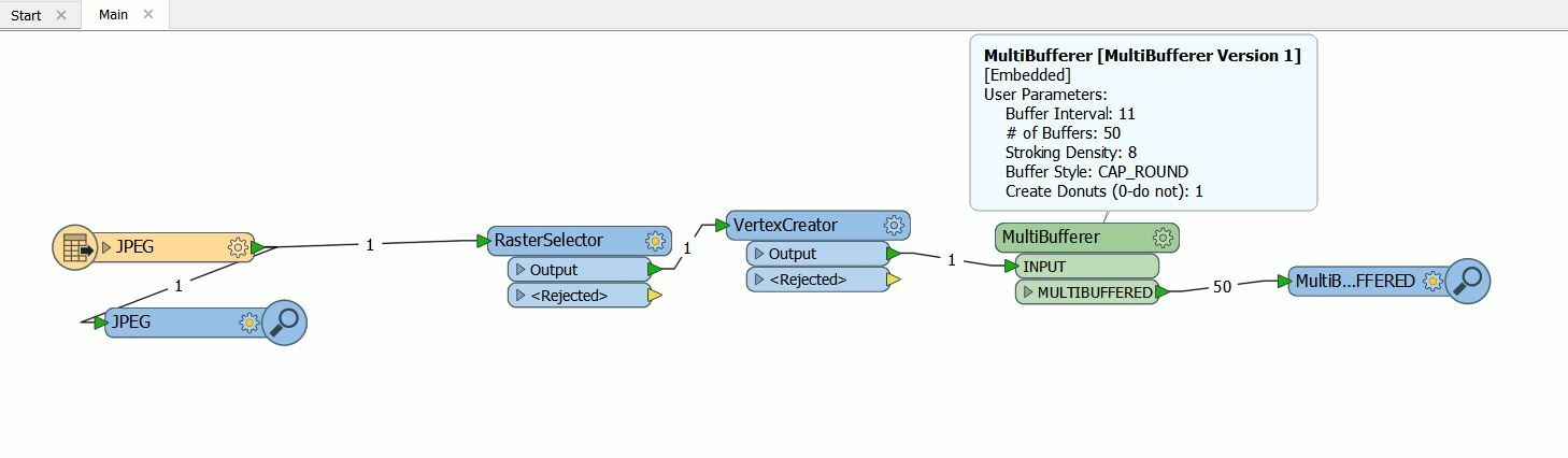

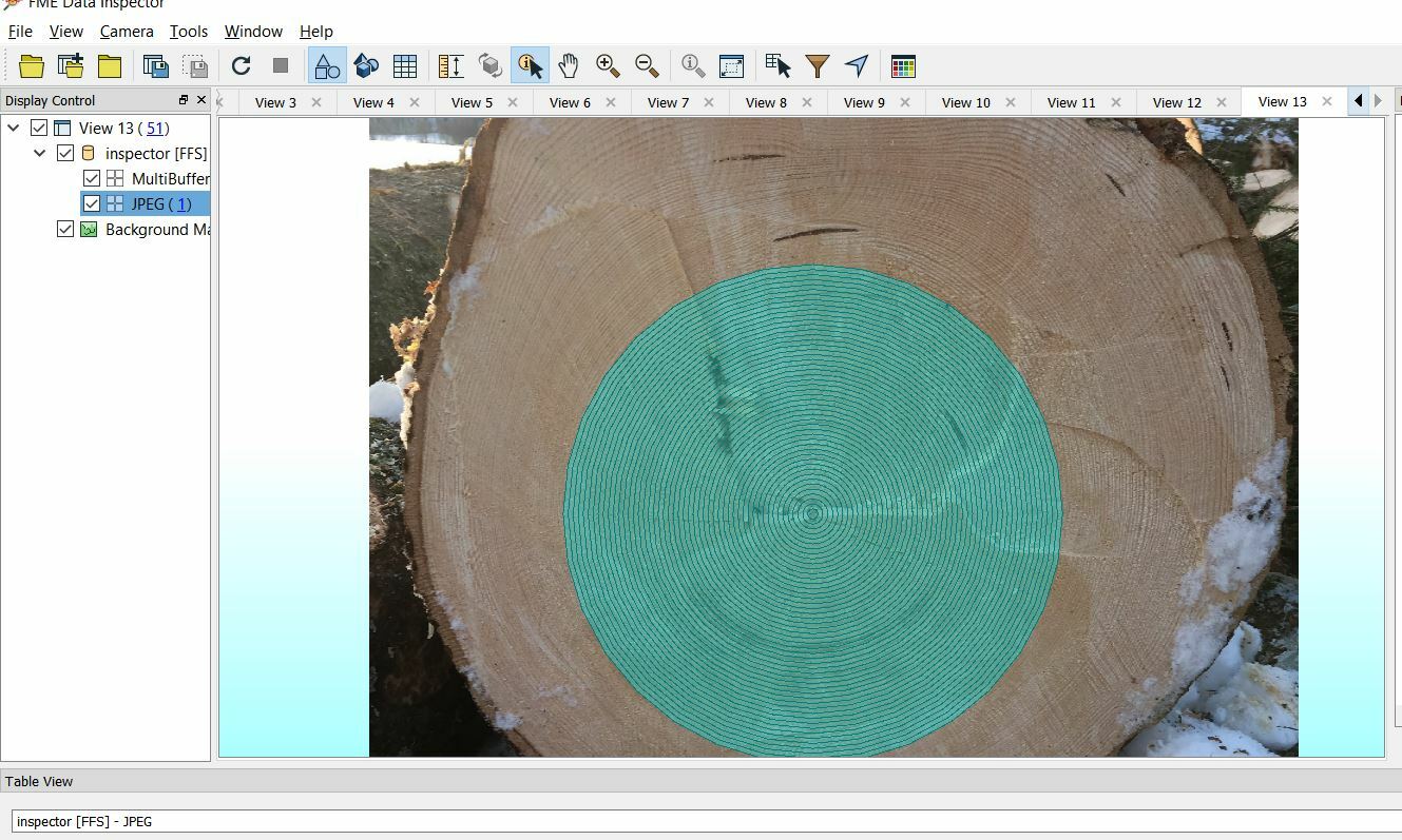

I believe on this way:
Read the image > find the center point > create a multiples buffers using the custom transformer MultiBufferer.
Workspace_Age_.fmwt

I read that it is called dendrochronology and is widely researched.
There are dedicated programs to do it, some more interactive then others.
Also many papers can be read or even downloaded.
So the challenge would be to inmplement some algorithm that does it.
Estimating center of tree and buffering is..well, if it were that easy then even I could do it! ;)
